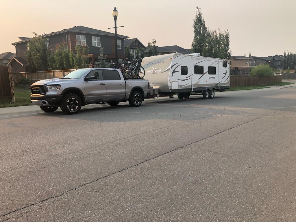

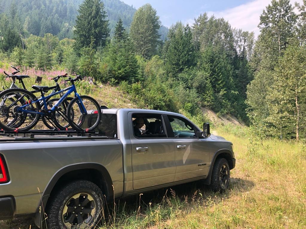

Good looking rig! Do you have a level or is that stock rebel height?
Dealer quoted me 5 to 6 months, would have been quicker if I wanted a hemi.
Stock height, just the 900 lb tongue weight and pointing up a small hill, no level.
Got that rig right before pricing went wild in 2021, and had to wait 3 months less a day from order to arrival. Dealer offered me $5,000 more than I paid to not take it home and 4 months later they were offered me $10k and then $12k more than my original purchase prices a few weeks later. The exact same truck is now going for $20k more than I paid. The market is nuts.
