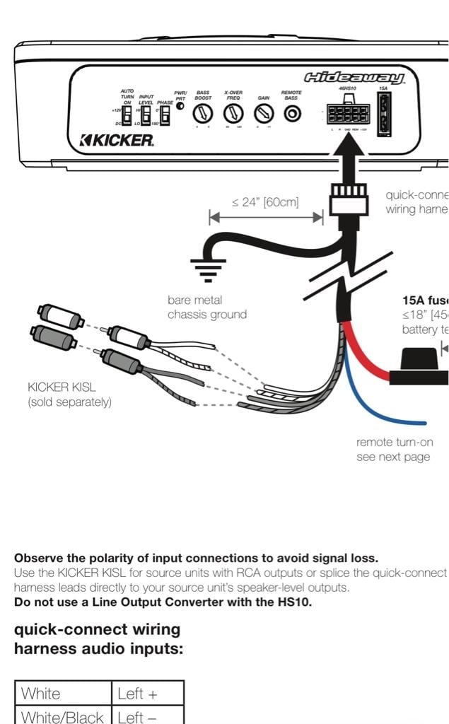

So I decided to go with the Kicker Hideaway 10”. I also bought a PAC ANC-CH01 harness, an Audiocontrol LC2i, and a The Kicker 46KISL speaker wire to RCA harness adaptor. All from crutchfield except the PAC ANC-CH01 harness I got from Amazon. I’ve done a lot of reading over the past few days as well had conversations with crutchfield. The plan in a nutshell is to install the ANC-CH01 harness, Tie in speaker wire portion of that harness to the input from speaker level side of the LC2i, then tie in the HS10 to the LC2i low level output via the 46KISL adaptor that I will wire to the HS10’s supplied harness. Obviously I will also need to run the power I mentioned in earlier post, I am not a speaker guy but I do have a decent mechanical aptitude and understanding of how systems function. Please let me know if you see anything off with my plan. Again I have a 2022 Ram 1500 Rebel stock 6 speaker system.
FYI the LC2i is for me to convert the high level signal to low level signal I need for the HS10 and it will also be helpful when I upgrade the stock speakers by easily giving me a way to install an aftermarket amp to power them. But all that’s for a future project. I will send updates as I get things done.
Why did they say you need the Kicker 46KISL?
See photos below. That may explain it better. The KISL is just a wire to rca adaptor with male and female rca connections. Please let me know if you see an issue.
