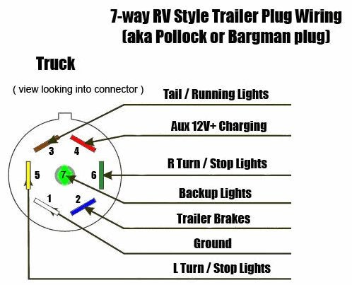

badpewterz
Jun 24, 2020
133
116
top red wire is 12v hot all the time
used it for my bed lights, left them on by accident and 2 days later dead as a door nail so definitely not switched lol
trailer-plug-7-terminal-description-jpg.81406
Interesting. wonder If I have a blown fuse...I could not get constant 12V off any of the pins. Thanks for this!
Maybe your ground lead wasn't making good connection to ground when you were measuring that.
