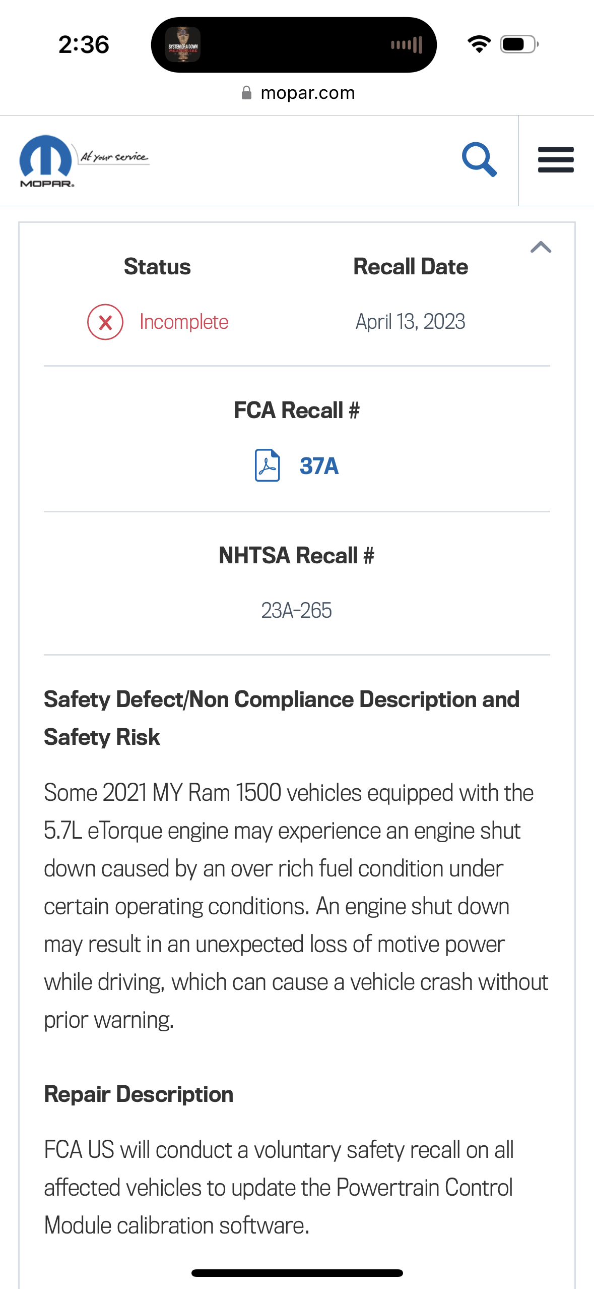

No, it's a new recall. Just came out. It is transmission. 2021 Ram 1500 Bighorn 5.7 E-torque.
It’s the pcm. Recall 23A-265 for over rich fuel condition.

If you actually read my previous post. It is recall 37A. PCM BCM. I showed a picture of the recall.
I did read it. That was just in the headline as a general description. No where in the actual notes does it say anything about the tcm.
And here is the actual real recall. Not a blurry screen shot. And the actual recall number ;)

If you look at my post where I pictured the recall, although the screenshot came out a little blurry, it said the letters had not gone out yet. From memory I think it said June.
Just got off the phone with my brother. It IS a transmission recall, although it effects engine fuel mixture. He just got the letter, although he has already gotten the recall performed. The over rich fuel was being caused by the TCM feeding bad info to the BCM. Like I said earlier also, he had complained about the truck drastically downshifting on light downhill grades. He came from a Ford, and complained comparing the two. I said it's normal to downshift to maintain speed, and said even my girlfriends Ford Edge does it. He insisted it was violent. Since the recall, his truck no longer has the violent downshift, and he is getting about 3 more MPG. Letters have started going out. He said when he has time he will send me a picture of the actual letter.
