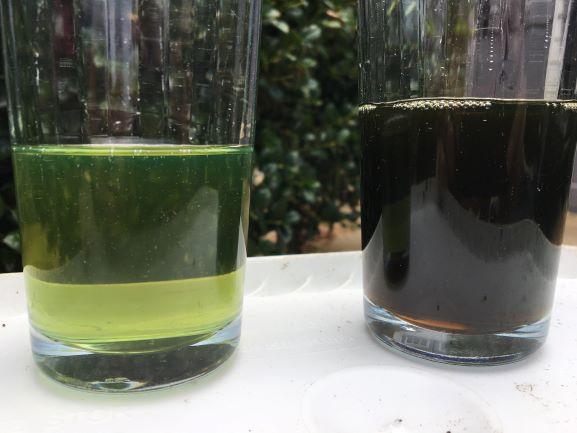

It might also be coolant. Chrysler's anti-freeze has a reddish color to it.
Smell of it. Coolant and tranny fluid smell very differently. If you have a dip stick for tranny compare the smell. Also feel of it, tranny fluid is slick and oil like. coolant is not.
Unless they changed the color recently zf's transmission fluid is a green color.
Looks like it mixed with the rain water, it's coolant

I guess the color of liquids changed since my last new car 12 years ago. :ROFLMAO:
