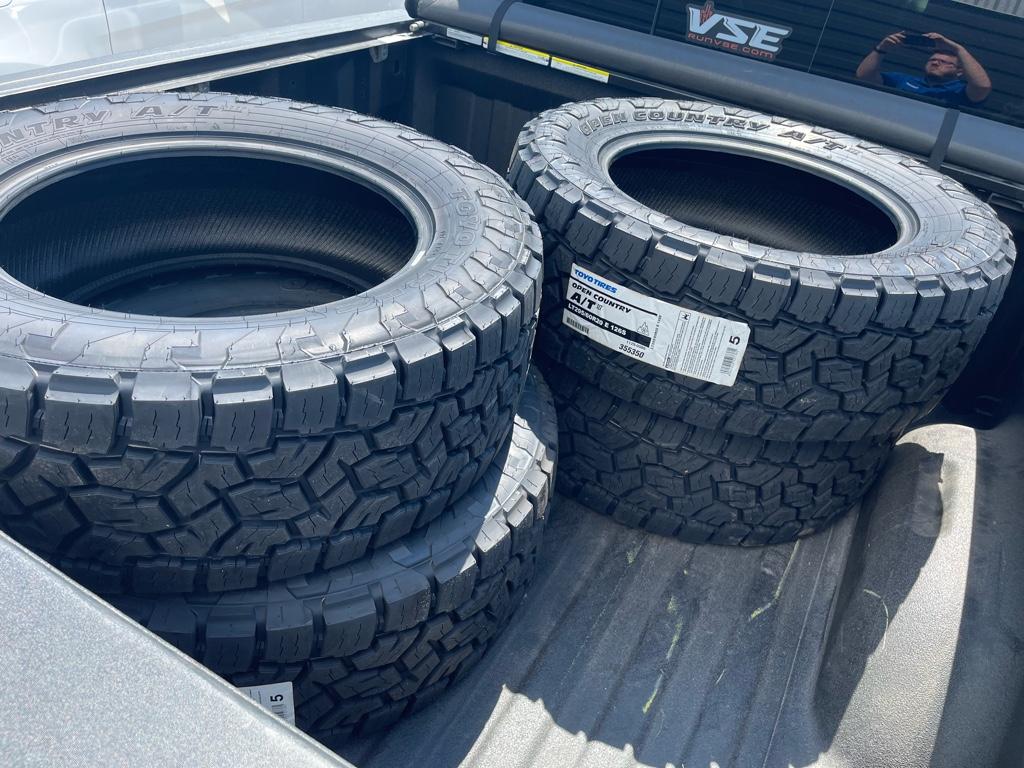

Perfect to hear. BC the warehouse had them in stock all with fresh date codes so they are in the bed now. Sadly. My front coil overs and rear shocks were to land tomorrow. Would have been ideal and how it was planned. They are momentarily lost and delayed. Shooting for Tuesday after work I can know the front out and toss rear shocks on her.
I’ll get the rear ORP springs in this weekend. Fingers crossed they still show up. Super bummed.

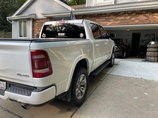

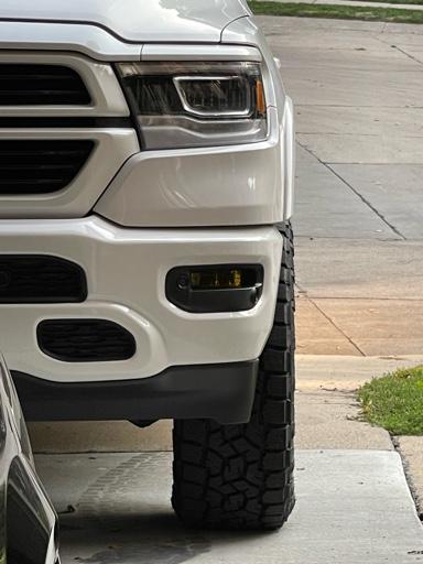

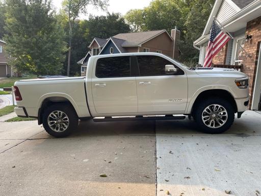

Here she sits. 2” level for the front. ORP Ram Box springs in rear for an inch. On 295/60R20 Toyo AT3 rubber. I do have a 1/4 spacer as well. Only bent the Mopar braket for the front flaps a touch on the insides. Rides great!

This is a bit late... so is it confirm that 295/60/r20 fits with no rubbing on stock suspension? I'm thinking of doing the fuel wheels 20x9 +1 offset with nitto recon
Talon4U2NV
Mar 4, 2022
196
90
Bellevue, NE
I'm leveled up front with the +1" ORP rear springs. With the stock tires, I do have a 1/4" wheel spacer just to give more breathing room on the front upper control arms.
