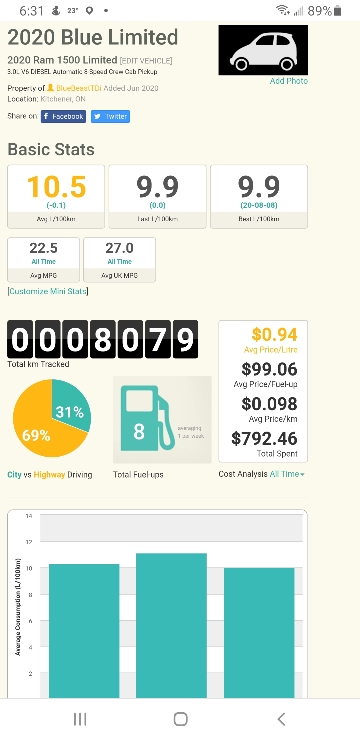

Happy with mine so far
Sent from my SM-N960W using Tapatalk
