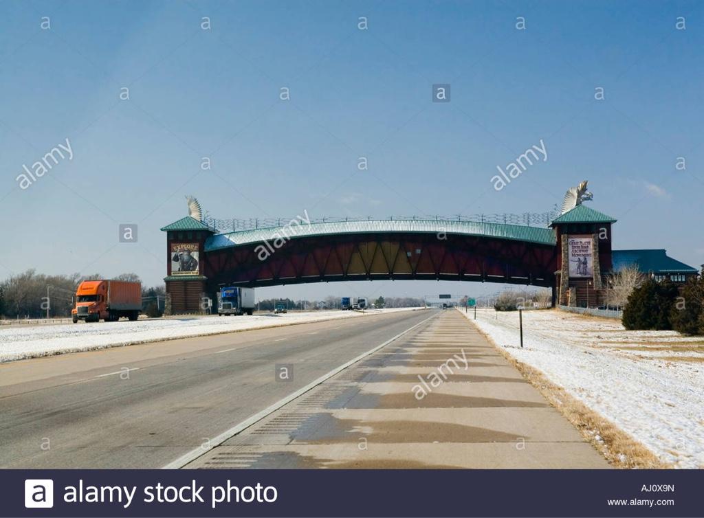

My cousin in Nebraska said when he was going about 75 mph and approached this walkway above the interstate his Beeped and locked it up to avoid the bridge or the bridge shadow on the interstate. He’s also a volunteer firefighter and responds to accidents and had him very concerned about that feature. He saw vehicle pileups at that location in the future.
