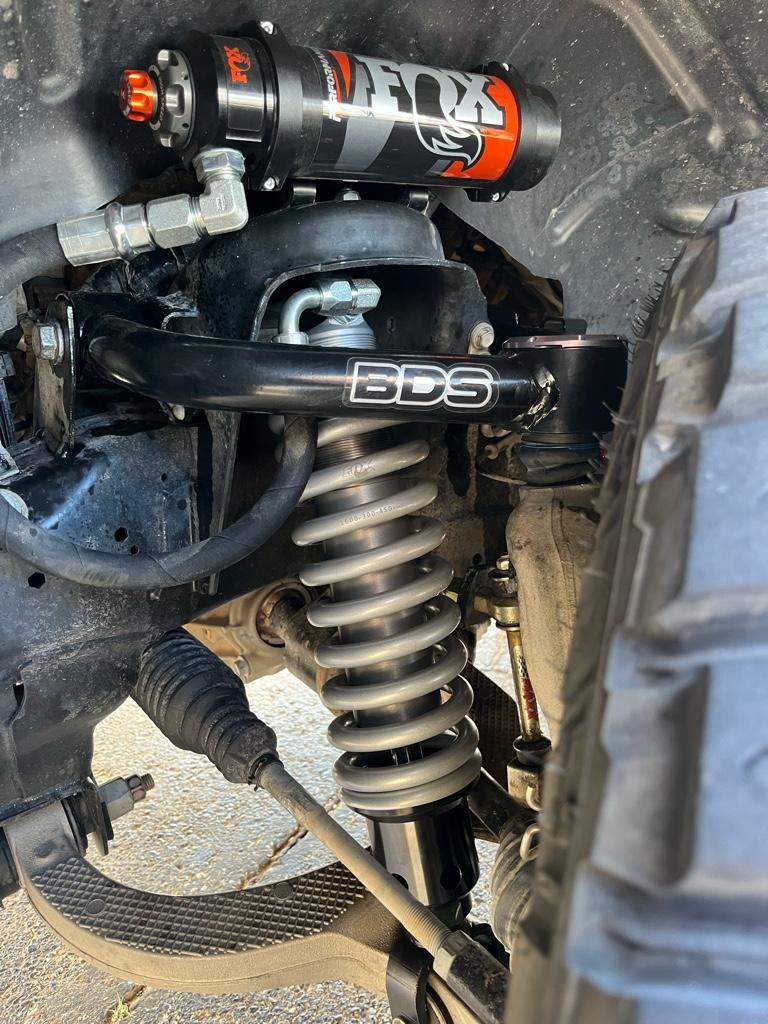

CHeYeNNe71
Aug 11, 2023
1,069
882
Eibach, RC M1 upgrade, BDS 3" w/ Fox.
RC has the 3.5, otherwise 4" and above you'll need to cut crossmember for diff drop.
CHeYeNNe71
Aug 11, 2023
1,069
882
Yeah I've done the 2, 4, 6" and now sticking with BDS 3" w/ Fox 2.5 w/ 285/65R20 Falken Wildpeak AT4W

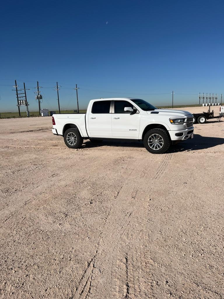

Can you upload pics of your truck. I’d like to see how yours sits at 3 inches because that’s prob about where mine will sit with the Bilstein 5100s right?

utlong31
Aug 30, 2022
69
123
Not the greatest picture but it’s filthy right now or I’d get a closer picture. I am running 295-65-r20 tires.
