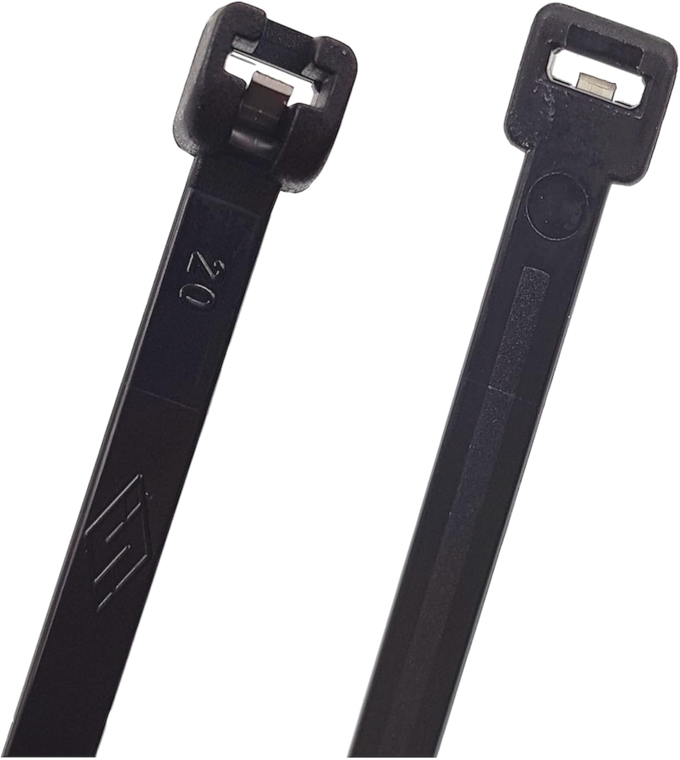

Could you just use a good zip tie? maybe one with the metal tooth to bite stronger.
So yeah like your original picture shows, the whole piece is an assembly. My Rebel conveniently has it colored red so you can see the whole thing. I'm not sure if just taking those torx screws out pops it out as I didn't try it, but the part you broke is in the second picture. Do you know how much you broke off or have a picture of it? Printing the whole piece not only wouldn't match your trim, but it would be a little too much of a feat for my CAD ability and printer without a 3D scanner. I could possibly print the little clamp and you could glue it though.
The zip tie might work depending on where it broke and if you could cut/melt a hole for the tie to go through.
By the way, pulling the panel off really makes me want to completely strip my stereo and put in quality speakers... Can't believe companies can legally get away with calling these "Harmon Kardon" with the sh!t that's in there.
They also make cable ties with blocks, you can put on the screw.
HellermannTyton CTAM1 Cable Tie Anchor Mount | Waytek
Amazon.com: Electriduct 4 Nylon Mounting Cable Ties Plastic Mount Head Screw  Zip Ties - 18 lbs - 100 Pack - Black : Electronics
Screw Down Cable Clip with Cable Tie Slot - 3 Sizes by sneaks - Thingiverse
That would probably work to hold it well enough.
Keep us updated. I have a few ideas on what I could make depending on where you broke it. I could make something that slips over or clips onto those edges that you could then glue/heat weld on.
