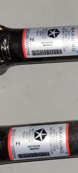

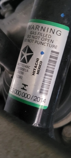

Shocks from my 2020 Laramie without the off road package
2016 Dodge Charger scat pack

Shocks from my current back country with the offroad package. Just comparing front shocks

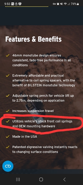

So not only have I proved myself (pictures dont lie) that the shocks can and will increase ride height, enjoy more facts from Bilstein website when ordering shocks...
I don't see anything saying it lifts. It fits up to 2.75" lifted trucks.

Uh, those are adjustable shocks that have a perch for the factory spring to either sit higher or lower on the shock housing. Shocks provide dampening only. You truly have no understanding of their name "shock absorber".
But don't tell me that a shock can't increase height. It can in different position.

The factory ORG shocks only have longer travel. They DO NOT increase ride height. It's the ORG springs.
You can't compare factory shocks to aftermarket shocks that have adjustable spring perch settings.
