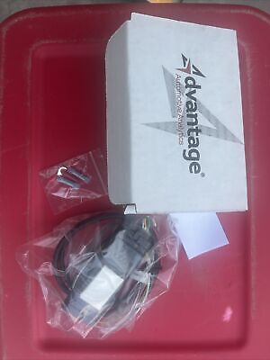

What is the attached device connected to my OBDII port? Do I really need it?
