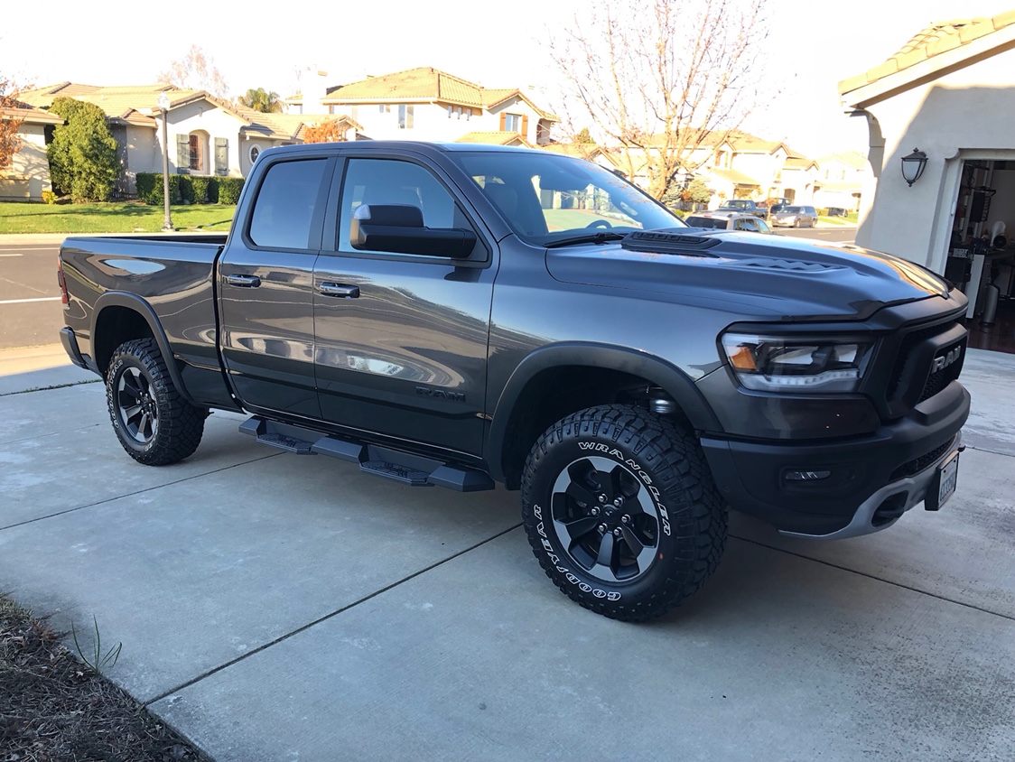

MOPAR matte black
extruded aluminum w/plastic end caps/step pads/bracket protectors
20 min install...9 nuts per side...NO thread chasing required
function & style with OEM quality & durability...perfect match for REBEL matte bumpers & trim
got 'em
FREE @ www.chrysler.ca/en/autoability
View attachment 18991 View attachment 18992 View attachment 18993 View attachment 18996 View attachment 18995 View attachment 19712

I also read the instruction to my OEM Mopar running boards, it states about 15 ft-lbs of torque, which isn't a lot, about the amount to tighten the drain bolt on my motorcycle. So I'll be doing my best to remove the paint on the threads so I can get a accurate torque set on the bolts.
