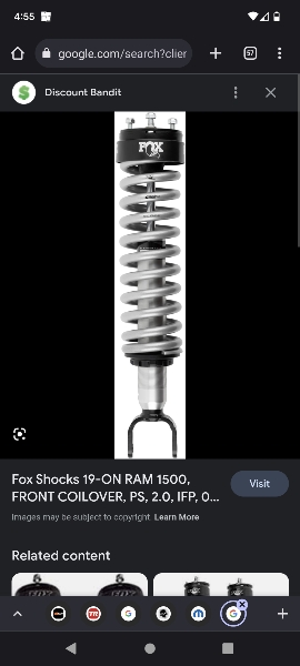

Poswah
Dec 24, 2019
7
2
I can't answer your question, but it looks like you have the Fox 2.0 coilovers up front. Part number 98502136. I'm curious as to how you like the ride? I'm looking at these to piece together my own 2"lift.

The fronts are Fox 2.0. They have the unmistakable Eibach coils. So, yes you can turn those threads up for more lift. You should be able to add spacers in the rear just keep in mind that the Fox rear shocks will ony let you go 2 inches higher over stock. And those sway bar end links appear to be Carli. Hope that helps.

Judging by your photos, it looks like you have the Commuter System from Carli Suspension. The rear end links and multi-rate rear coil springs give it away. This lift/level kit comes with special custom tuned Fox 2.0 shocks and is not a standard Fox 2.0 shock. Their shocks actually have a slightly different part number than the standard shocks (first 3 digits are 986 vs 985 with the standard shocks) due to the custom tune. Carli has their front coilovers set for 1.5” lift up front compared to stock without the Off-road Group, so I’m not sure how much more adjustment you have from there but I’d imagine you’d still have some wiggle room. The rear multi-rate springs provide a 1” lift from stock assuming you have their standard rear spring, again without the Off-road Group. I don’t have this setup myself yet, but I’m seriously thinking of going with this system in the near future hence why I recognized it. It may be worthwhile to try reaching out to them to see what they would recommend for adding additional lift.

I think this is your answer.
