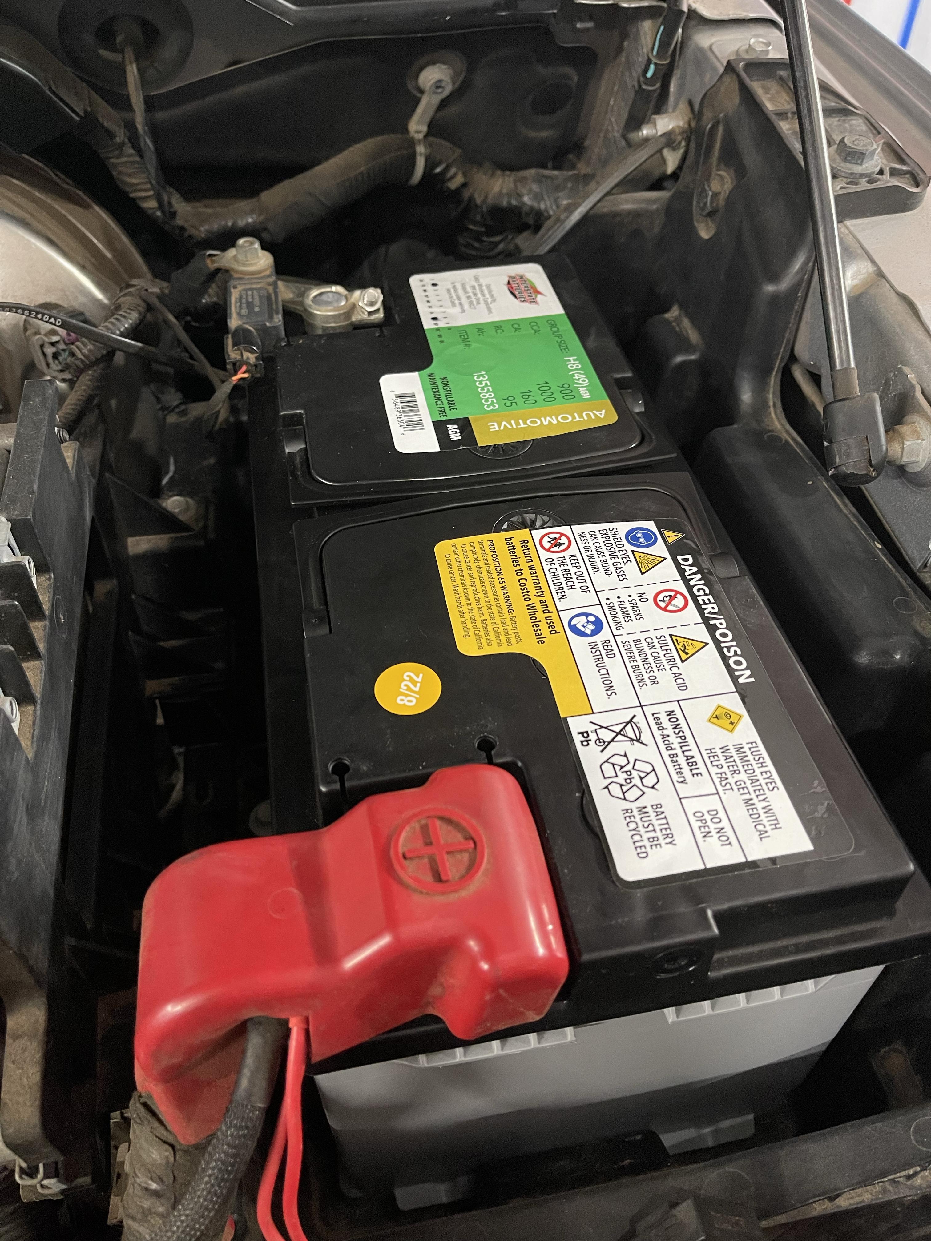

I need to put a new battery in my 2019. Has anyone put a H8 AGM in their truck. It seems like it would fit but curious if anyone has had success doing it.

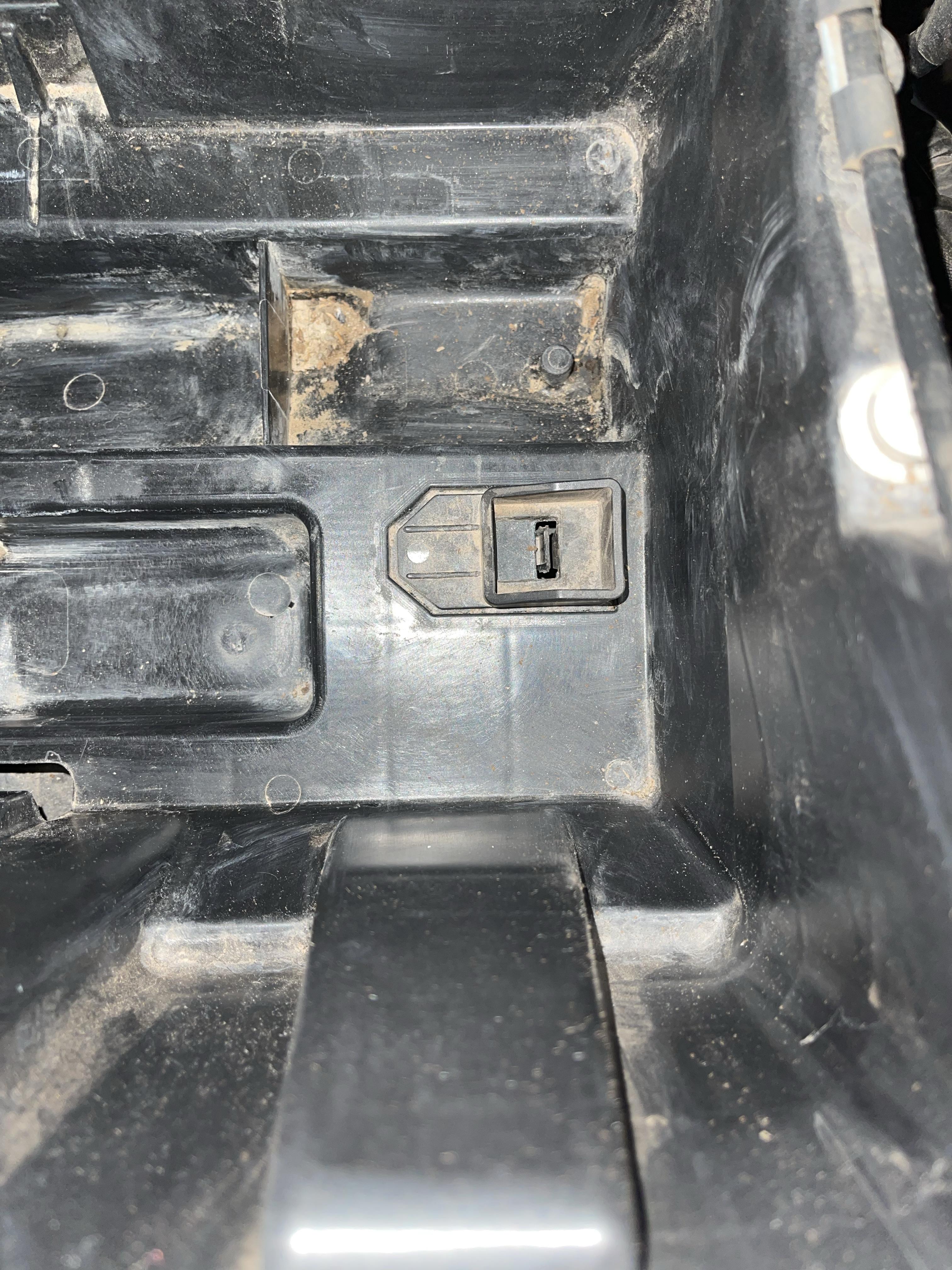

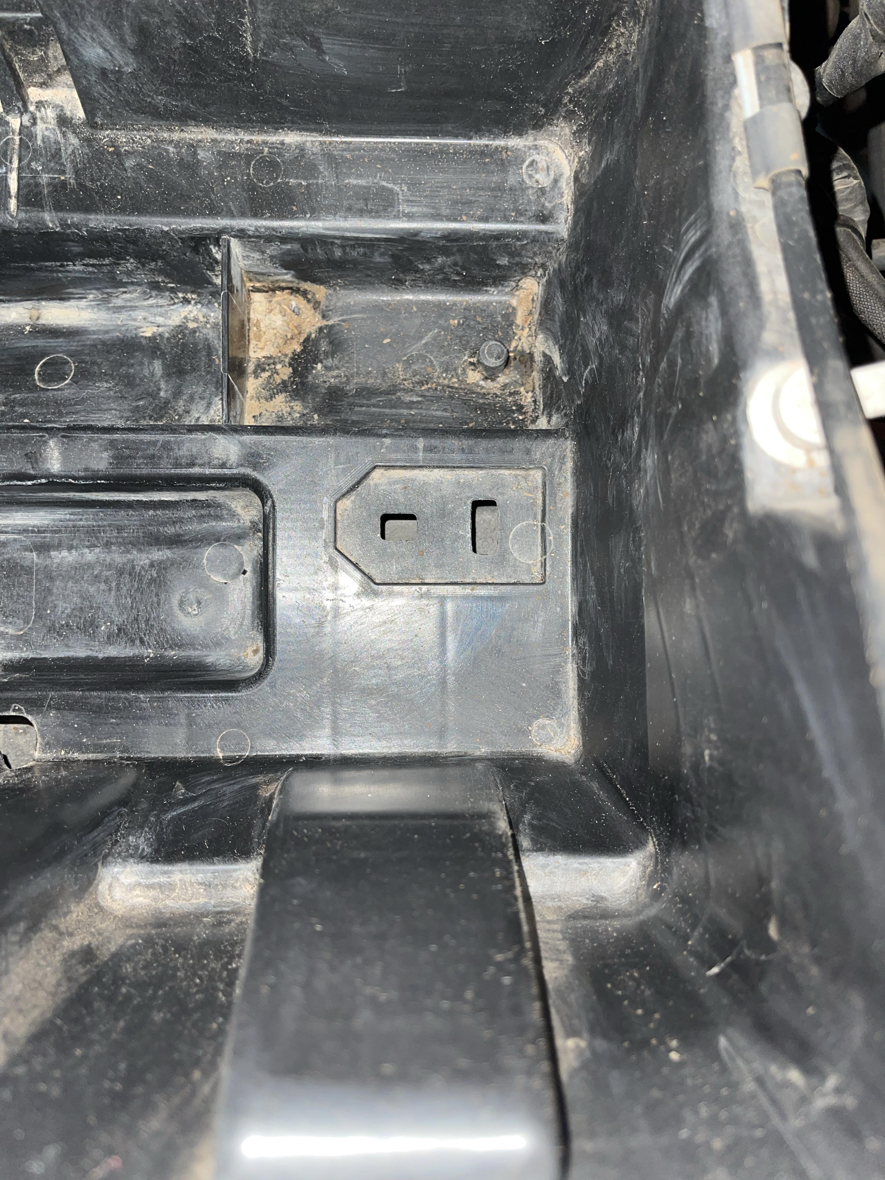

The H8 will absolutely fit once you remove this small plastic spacer at the bottom of the battery tray.
I recently upgraded to an Interstate H8 AGM myself.
