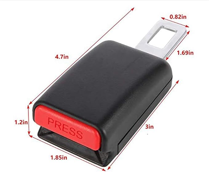

2. A seat belt extender, like the following, will prevent the light and chime and still allow you to use your seatbelt. (Amazon Link)

#2 Dangerous. Had them when I totaled my 20. Knee hit dash, surgery, I will never walk without a limp.
Your limp may be more related to a crash that was severe enough to total your vehicle than a "dangerous" seat belt extender. Also, it won't add any danger whatsoever for those using it to extinguish the seat belt chime and light because they don't wear a seat belt.

Actually my responses are correct. My leg hit the dash, because the extension puts the point where the belt changes direction 3 inches closer to the dash than it is designed to be. He is not talking about auto park, he is complaining about not being able to back up with the door open, which is a new safety feature. If you get out with the truck running, it does not apply the parking brake, but when you get back in, it will not go out of park with the door open. The reverse auto stop can be deactivated with the switch, but will not turn itself back on. You can also turn the auto stop off independently from the notification, in the radio settings.
