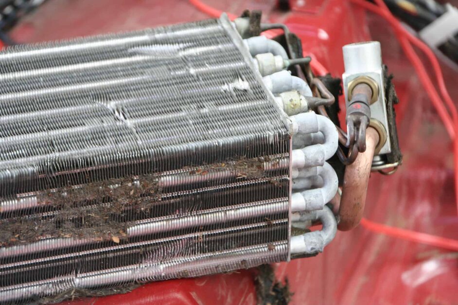

I had this issue in my 2019 Lonestar. I bought an ozone machine off of Amazon for $50 and ran it in my truck with the air on recirc for 30 mins and that seemed to clear it up. Might be worth a shot for others too.
You may not notice any dampness on your floor. It could be the condensation drains in your AC system, and the moisture is staying inside AC unit, hence the moldy smell when you turn on the fan.

I’ve got a 2020 that I bought last May. It had a musky smell after about a week. It took 5 visits to the dealer before they were able to replicate it. I got lucky in that they covered an $800 procedure to decontaminant the evaporator. That was at the tail end of the warmer months last year, and there were no issues for the short time I still used the A/C.
Fast forward to the last month - I’ve been lightly using the A/C recently and could smell it coming back, while hoping it wouldn’t get any worse. But, I just used the A/C extensively for the first time this year and it was awful.
