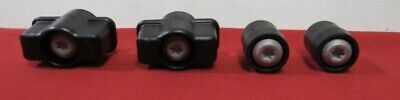

In June, purchased the 2020 Ram 1500 Limited ecodiesel with Rambox and multifunction tailgate. Expected to get the bed divider/extended (68027145AE), but didn't. Expressed my disappointment to the dealership. They shared with a regional sales manager. Regional sales manager explained that bed divider/extended (68027145AE) will not come with 2020 models. Only if a Bed Utility Group (BUG) is purchased with truck, a new divider-only is included. They did offer to send me the previous one (68027145AE). It lacked the lock cylinder (68402268AC), 2ea pivot grommets (68054997AB), and 2ea swivel handles (68054996AA). Expressed that this part was incomplete to the dealership. They agreed to pay for these remaining parts. Local dealer keyed the cylinder to match truck key. Installed all yesterday and works perfectly.

You have to order the lugs. they no longer are included:
I got them here, and these are the parts you need. Remember, you need 2 of each, total cost about $95.
FactoryChryslerParts.com
68054996AAHANDLE. Swivel Release.2
68054997ABGROMMET. PIVOT JOINT.2

Actually, I think there was a liability issue in that when the extender is in place, it can block a tail light. So, they discontinued including the lugs, but at least they are still available so we can DIY it.

We went thru this long ago in another post .. ask your local dealer .. mine were $31 total.

If you have the divider, you have the extender. You just need to get the lugs to hold it in place.

I've got the Rambox and Multi Function Tailgate, and my bed extender works just fine. Ordered the parts off ebay and installed very easily. Mine is a 2020 1500 Laramie 5'3 box
