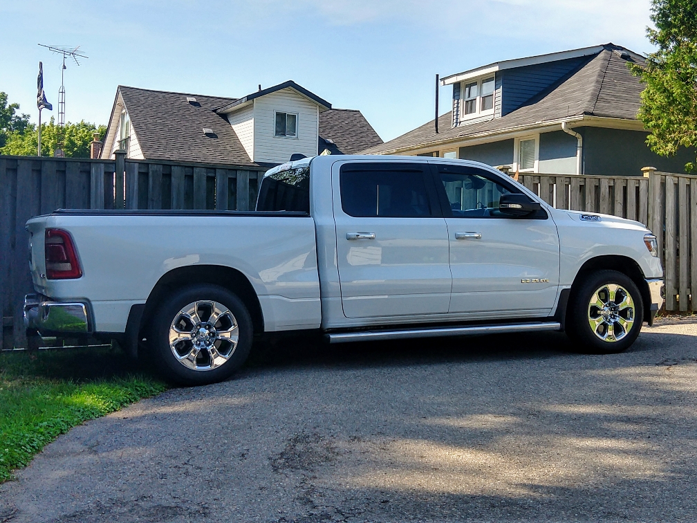

Installed maxtrac 2” springs on my 2020 a few days ago. Definitely could tell it lowered the rear. Rides like stock. I pulled them back out and cut 1 full coil off each spring. Now it sits level and I love it. Rides exactly the same as factory.

Mopar_maxi, I have the exact same truck. Can you post different photos? Different angles of the truck? I am doing this to mine as well.
