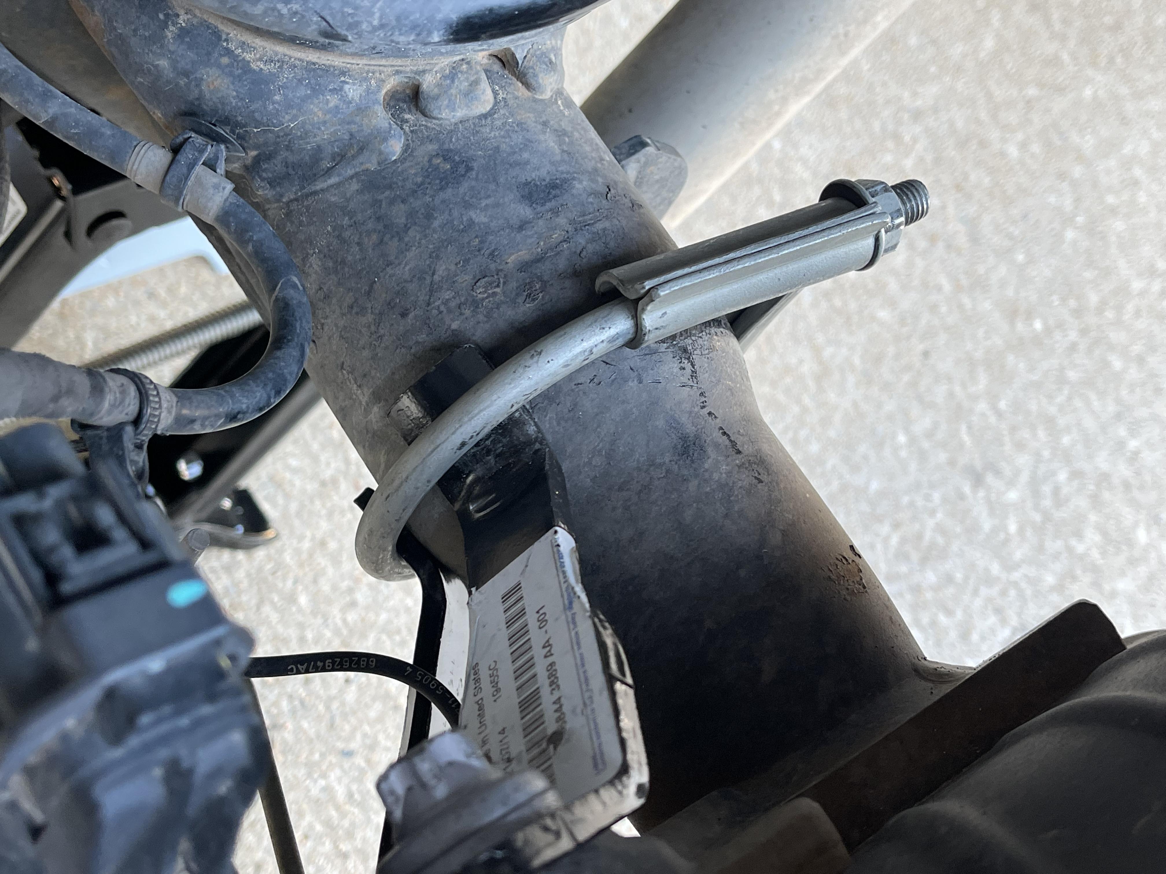

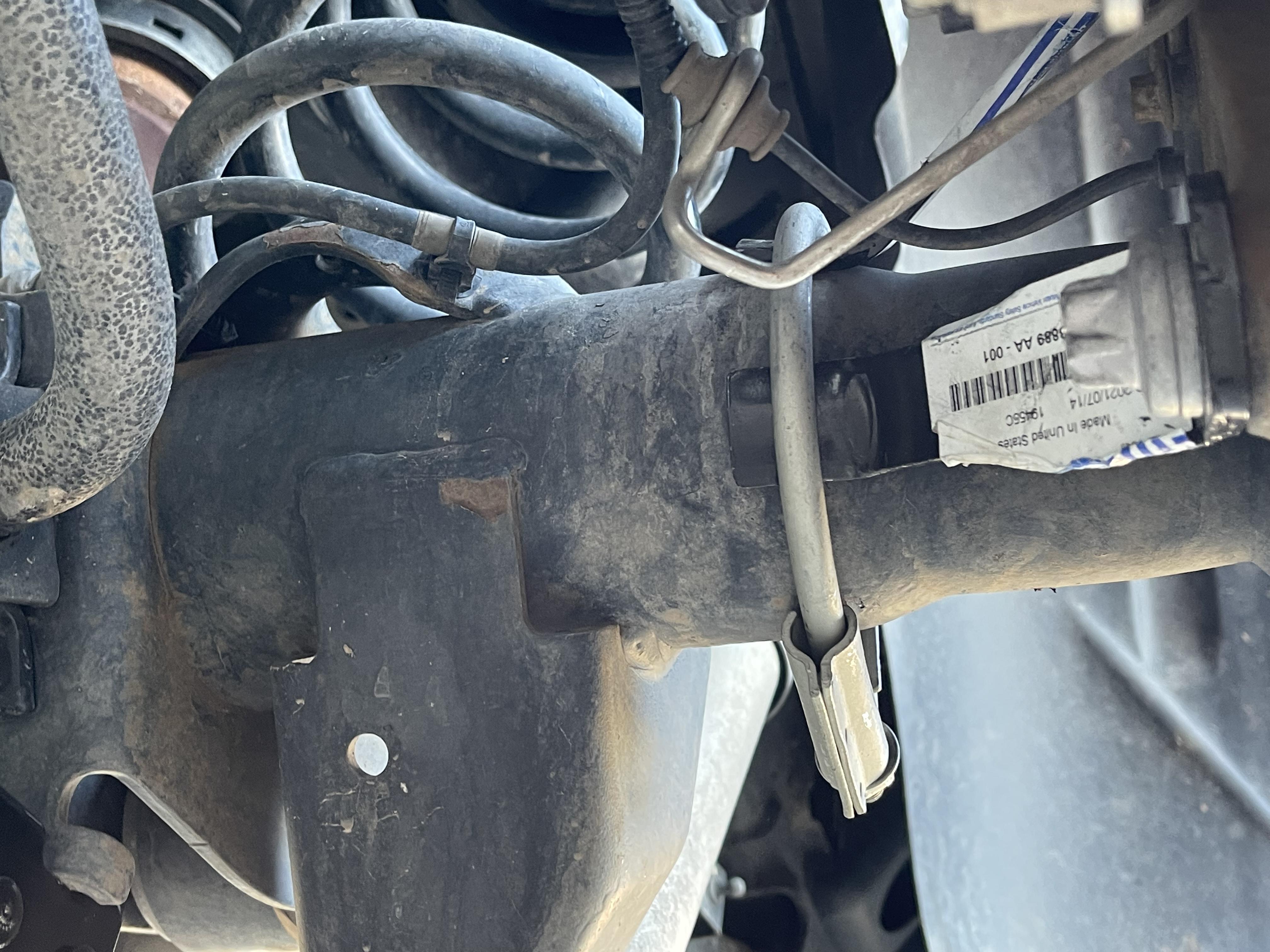

I recently installed the anti moan brake kit (Part # 68446866AA) on my ‘19 and it has completely silenced the rear brake noise. Very easy to install and well worth the $63 I paid for the kit shipped. Others have stated that the noise can possibly come back after a few years, so we’ll see how it holds up. For now, I’m just glad to be rid of that annoying noise.
The bracket and clamp in the kit reinforce the caliper by securing it to the axle, which reduces vibration/noise.

WTF??? I thought you were joking! That C clamp is their fix???? wow.....
Is this kit for the rear brakes only? I haven't been able to isolate if my front or rear brakes are the issue but it does "appear" to be the rears

Yes, it is a crude design but it works. It was actually issued with TIB 05-002-19. This kit is for the rear brakes only. 1x of that part # will do both sides. There were times were I couldn’t tell for sure whether the sound was coming from the front or rear, but it was definitely just the rear as I have not heard any moan since installing this kit.
There was another TIB (05-001-19) issued for this problem that involves replacing the rear brake pads, caliper adapters, pins and bolts.

That site is just using an incorrect image on the product page. Most of the Mopar parts sites don’t even show a photo for the part #. I can assure you part # 68446866AA is the correct part # for the bracket/u-bolt kit.
