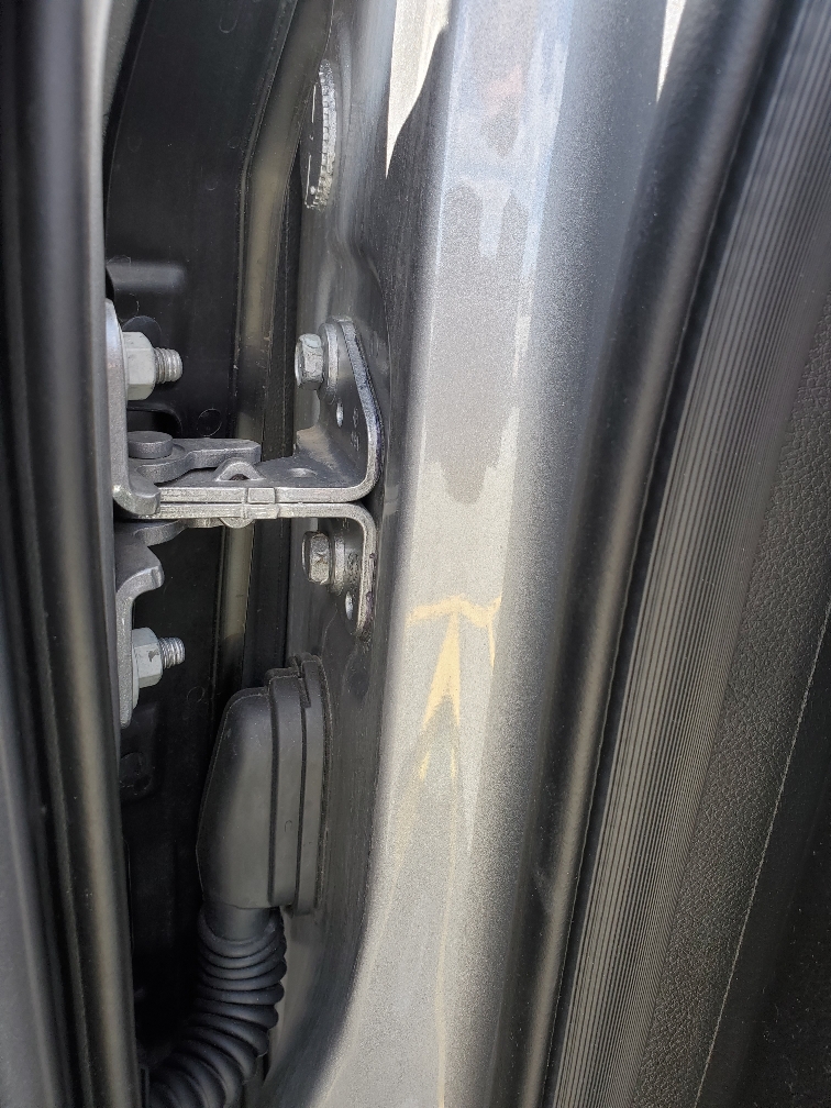

Ok so I fixed the wind noise from my drivers side door up top. The strikes can be adjusted but that wasn't the main issue. The door was off at the hinges. Comparing the top of the driver's door to drivers side passenger door the front drivers door was off by about an 1/8 of an inch lower than passenger door. Loosened bolts on drivers door supported it with jack and pad. She lined right up. Adjusted striker and no more wind noise and looks a hell of a lot better too. Just an fyi fellas.
I tried the foam weather stripping and did not have any luck. Im seriously disappointed in the quality of this truck. Since this is not a safety or mechanical issues I really dont think Ram is going to address it. I think they need a thicker weather strip around the door.
Hi Bighorned - as far as the hinges go - did you loosen the bolts on BOTH the door and the truck sides of the hinge? Or just one side of the hinge to get it to fall into place? Thanks!
I loosened up the ones on the truck only.
And you adjusted the strike too? I loosened my boots but the strike didn’t seem to move. Did you oblong or file the holes larger?
