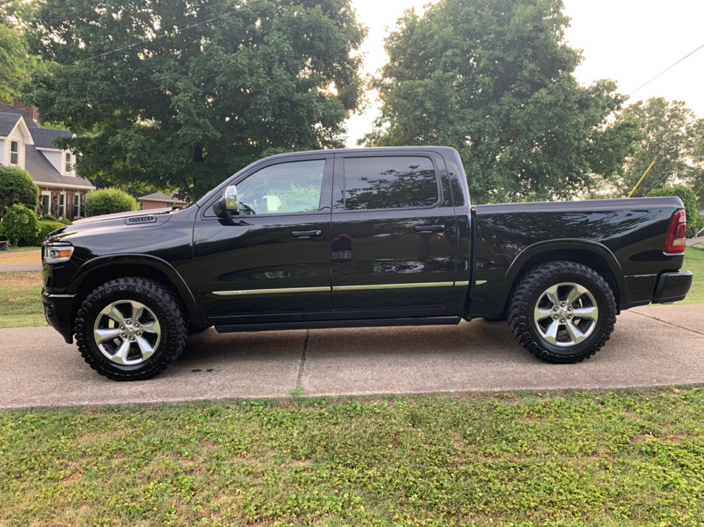

Here you go.
Painted to match body color
You taped it off your self and painted this badge ? I wanna try this but not sure I have the taping skills lol ! looks nice with the white background and eyes !
