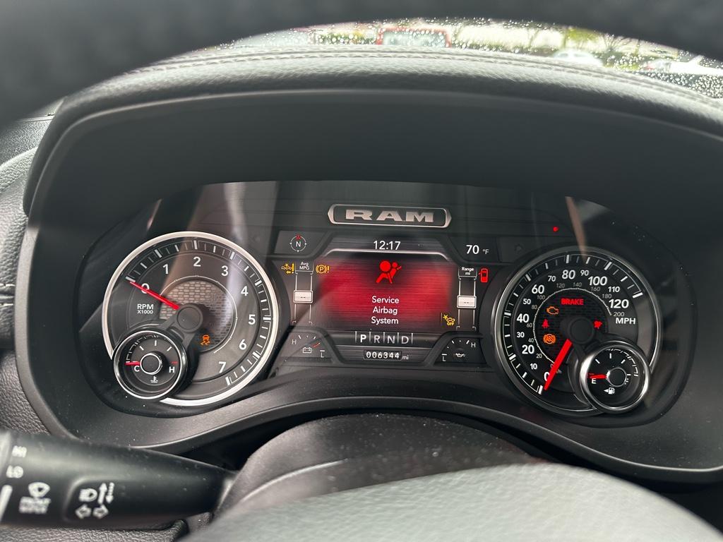

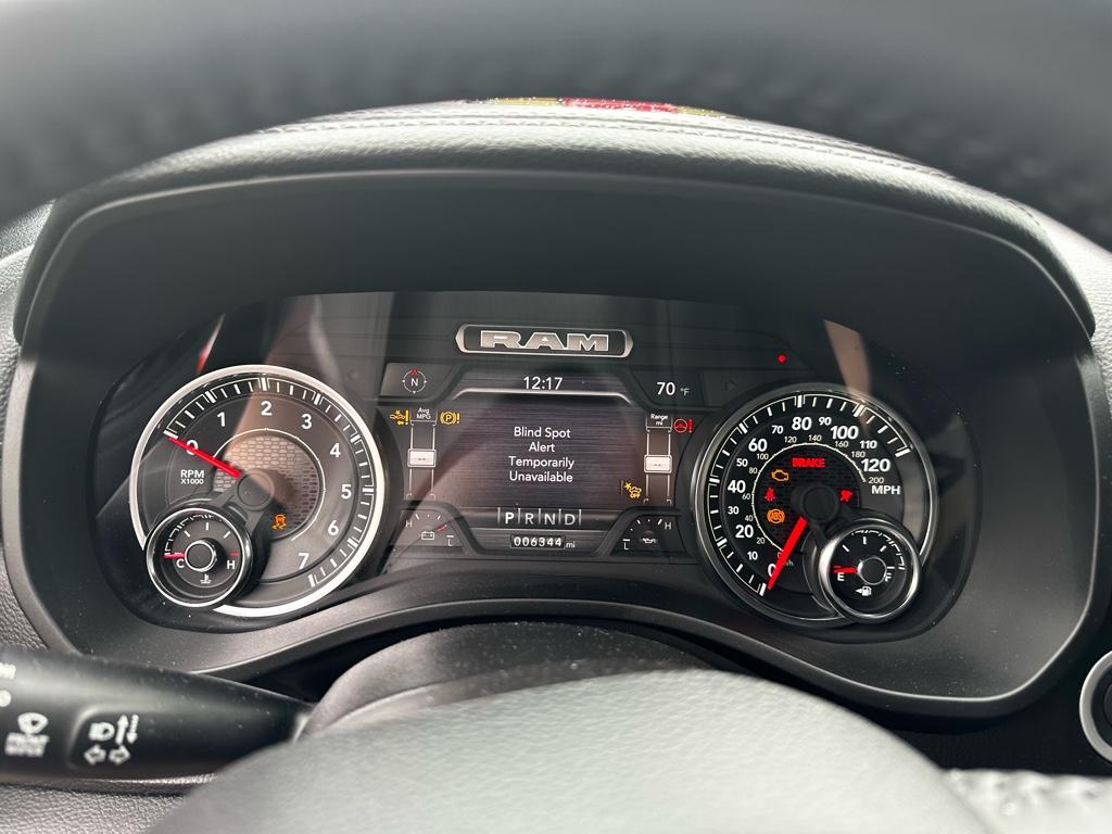

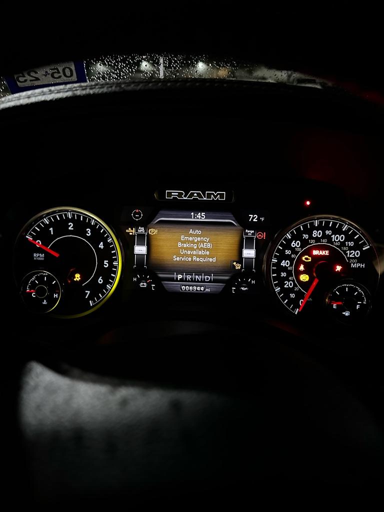

So I was about to head home get in my truck and all warning lights came on and brake was slammed to the bottom. This is a 2023 with 6,000 miles. I had a 19 and a 21 5th gen with 0 issues. Truck would not start but had power to everything. It all went crazy and would not start. Literally ever light possible on the dash came on. What do I do?

I get bored and have had alot of positive equity in my 19 and 21. But it has 6,000 miles I don’t know how it could be a batter issue. The brake went to the floor wouldn’t move. Yet the power running boards radio and AC all worked but all lights came on and truck wouldn’t start. Picture shows one warning in the screen but before that there was an air bag warning and multiple others.

so trying to look it all up for you and figure it out. so far what i got is check your sensors and wipe them clean and surroundings to ensure nothing is around it at all. might have been right when you parked it sensed something and put the auto brake on. if so try putting in N to roll away from whatever it is. also found this therad maybe itll help Auto Emergency Braking Error.
Where is this sensor located? I've got the same lights on for nearly a month now (forward brake warning/off). I'm assuming in the cluster behind the rear view mirror?
I checked that thread you posted and found a part number. I want to try to clean it before buying

It wasn’t just that warning light was every warning cycling through on the screen. Today they still don’t know what happened. My random theory is it had a high pitch whistle when I was going over 60 like a dog whistle that some people can’t hear over a certain age. Sounded like it was coming from under the windshield. It was raining that night so I’m thinking possibly water got in just the right spot and fried the computer. I’ve read on here or maybe somewhere else where people who got ceramic clear tent on their front windshield their computer got fired by the water the installer was using. I did not have this done but using that theory maybe it’s a possibility if my windshield wasn’t properly sealed. Although it’s been through rain and about 3 washes a week but maybe it just got to the right spot that time. Talked to them today and they still don’t have an answer for me.
