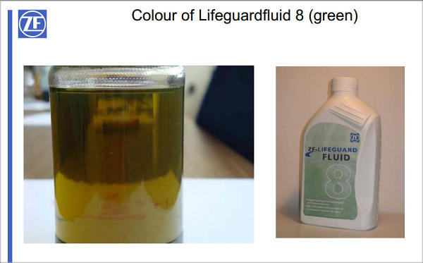

Isn't there also a UV marker in the ZF transmission fluid? Are we sure that what we're looking at is engine oil?

As Gman suggests I would be worried about possible trans leak. These trans come with dye in the oil. The engines do not. To diagnose this properly, the tech should have used a UV light when you first brought it in. If the UV lit up oil, it would be a trans leak. If not, then adding dye to the engine was the next step. If he never did that and just added dye to the engine, he will not know the source of the leak. At this point it does not matter. When he pulls the trans back he will see the source of the leak.

This fluid is not red in this trans. It is more like a golden light brown maybe toward green. If that matters
Ahh, my bad then. I stand corrected and doubled checked it is as described above thanks for clarifying that.(y)

Also, my first post when I saw, I assumed transmission leak and everyone told me nah, that's oil. Go figure. That said, if I compare the dipstick to the drip, they both react to the UV, but dipstick seems more green but I'm splitting hairs likely.

I had no clue that the ZF Lifeguard fluid looked darker and was greenish in color, until someone explained it to us (and included a picture) in a conversation about the ZF 8-speed. I didn't have a clue as all previous iterations of trans fluid I've dealt with were red.
