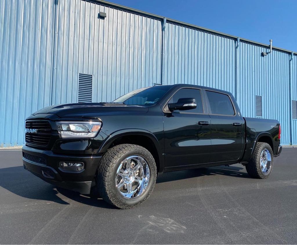

Update: swapped to a 2” ReadyLift level!
During removal, it was learned that the front suspension was totally messed up! Had a cracked spindle, and bent control arms… probably from the massive pot hole I had hit two years earlier! I had it inspected at two authorized installers, who both said it checked out fine - and only noticed when I had the weight of additional adults in the car (rare occurrence). But, IHC replaced the entire front suspension lowering kit under warranty!
On the way home from the install I stopped by the dealership… and the rest is history! Traded it in for more than I originally paid in 2018 and got almost $10k off a 2022 EcoDiesel. Leveled on 305/55/20 - definitely a different look than lowered!

And I ended up getting a new truck within a week of changing from lowered to leveled anyway! But, I did end up going the Hostile route!

Picked up my Laramie Sport from the shop last night, it was lowered 3” in front and 5” in the rear with a kit from Inez Hotrods. The front was done with upper and lower control arms, and the rear with springs and 4-link relocation. Tires are 285/45/22.
