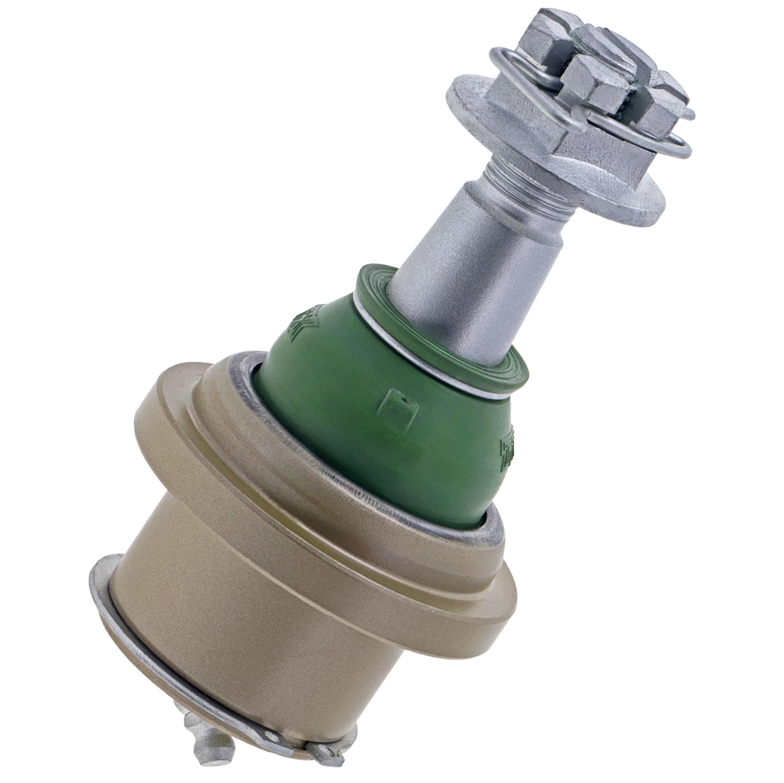

On a side note the Mevotech ball joints can be removed and replaced for future issues if any.
Do you Know the part number for the Mevotech replacement ball joint?
