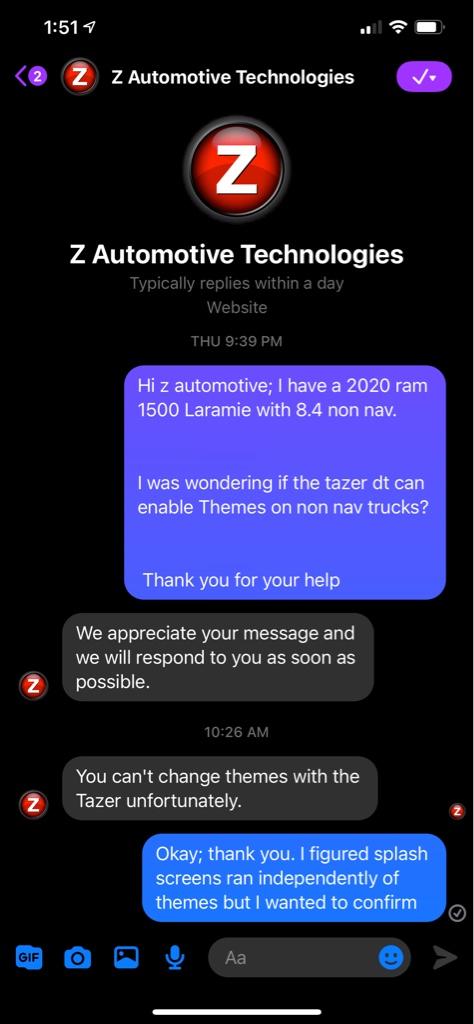

Hi hoping there’s someone smarter than me that can help me understand this better.
My 2020 Laramie 8.4 non navigation is great I absolutely love it.
But I’m wanting the theme inside the limited (blueish with white text) inside the cluster.
Is there a way to enable that with Alfaobd a tazer dt or something else?
Any guidance would be appreciated

You can only get that function by upgrading to a nav unit (8.4” with nav or 12”) or using the tazer dt.
That’s what change cluster splash screen means

The SPLASH SCREEN is not the Theme!
What else could you possibly change within the cluster other than the ability to go between Laramie, rebel and limited theme? Sorry if I’m incorrect that was my only assumption of what you would want to change. I spoke to a member that change his to a rebel in the cluster via the tazer
Did confirm it’s splash only for tazer.
I kinda guessed it’s just a short gif or video clip then would revert to the original theme.
Thanks for your help everyone so far.
Does anyone have a non nav 8.4 with alfaobd that could check that out, or point me to another resource?
