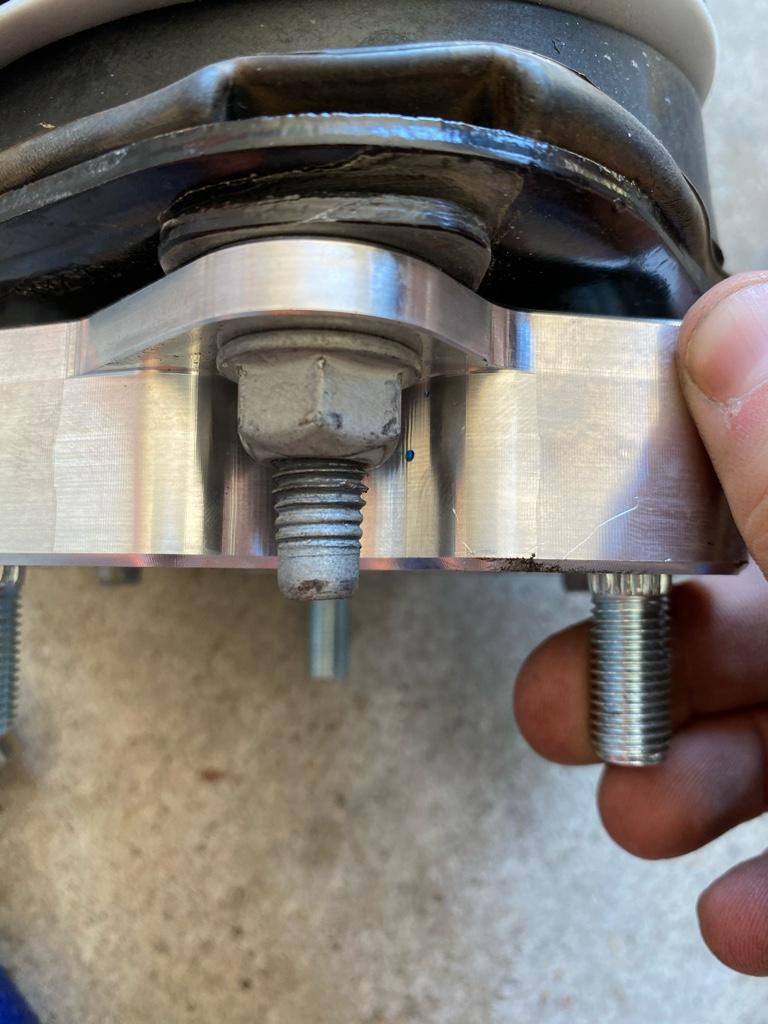

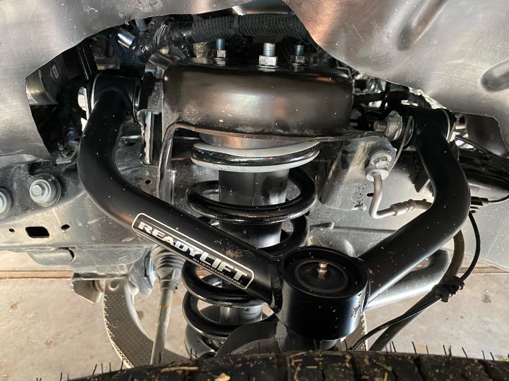

i’m very happy with the readylift kit, both with packaging quality, material quality, welds, and pretty much all aspects. BUT...the top hat spacer didn’t clear the studs on the strut. this is a simple grind down, doesn’t bother me...but the instructions don’t say a thing about cutting down strut studs up top.
to be clear: if you did not grind down your studs...
you’re lifting your truck with the height of your strut studs!
pics below

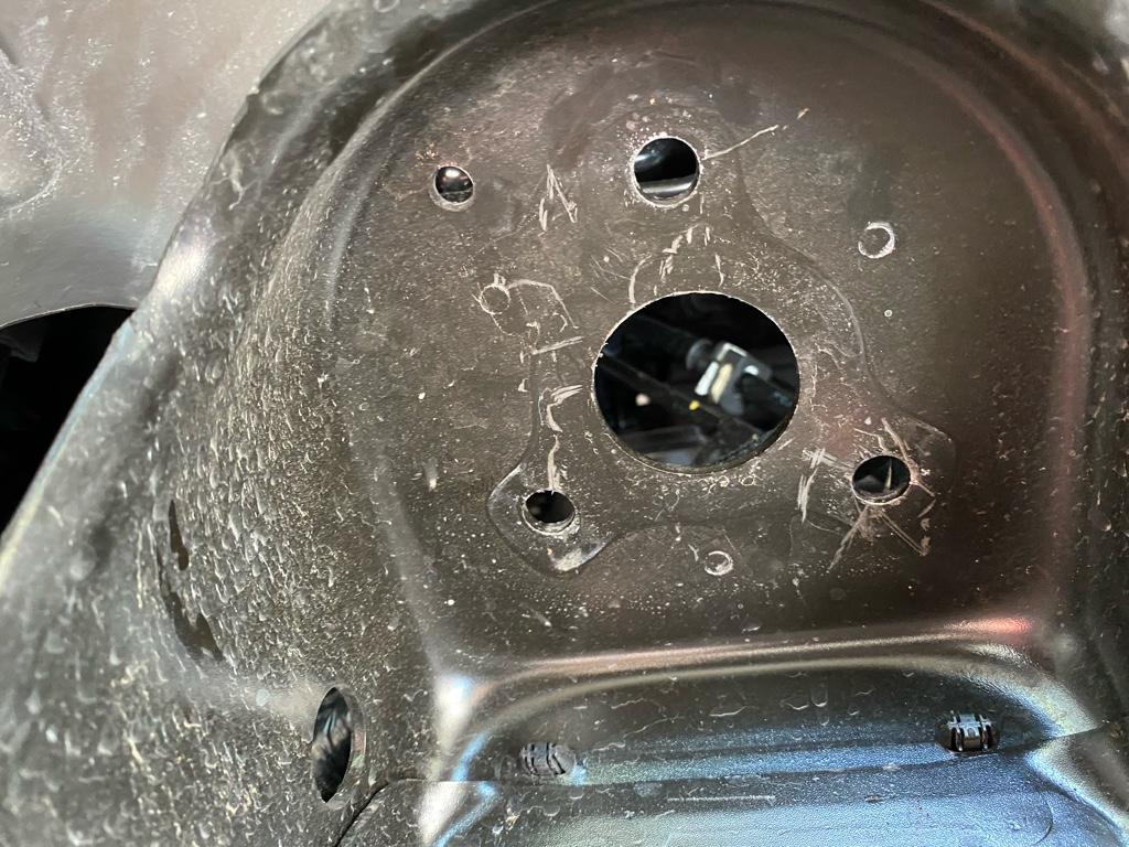

you can see that the weight of the truck was embedding the studs into the strut tower. this is a no-go from me, and i would assume many of you as well. i’m going to reach out to ready lift and request they update their instructions to include checking the studs for clearance. i was mostly frustrated because we had already finished driver side and moved on to passenger side before my buddy noticed. i got a zip tie and poked it through the strut tower, and the clearance between the strut tower and lift spacer was enough to “lose” the zip tie. needless to say, we ripped the front end back apart and got things straightened out.
i am still happy with the aesthetics, and the quality of the control arms. this is really why i bought the kit. i might jump up to a 2.5” spacer, or bilsteins depending on ride quality. right now i love the lift without losing that land yacht ride quality.

thats a good thing! all you’re doing with a zip tie/stiff piece of bendable material is trying to check for a gap between the lift pacer and the strut tower. if there’s no gap, you’re fine.
of course the only way to be 100% sure that there is no gap, is to pull the strut out and inspect the stud length vs. the spacer height. if yours doesn’t look like my picture, you’re good to go.

I finally got around to emailing Readylift about this. Their customer service manager replied, and really just said ‘we plan to edit our instructions. We are seeing a few vehicles now with different stud lengths, and the way to fix it is to trim the studs down.’
i’m not crazy about that being their fix, but i cant argue that it is ineffective. that really is the simplest way to fix. My biggest thing is that it creates a big question surrounding folks who bought the kit and had a shop install, or just didn’t know to look for it. I didn’t, my buddy noticed it at a glance. Just one of those things to talk about i guess. I might need to start another thread on here that brings attention to it, just in case its causing damage or a potential failure point to all who run the kit.

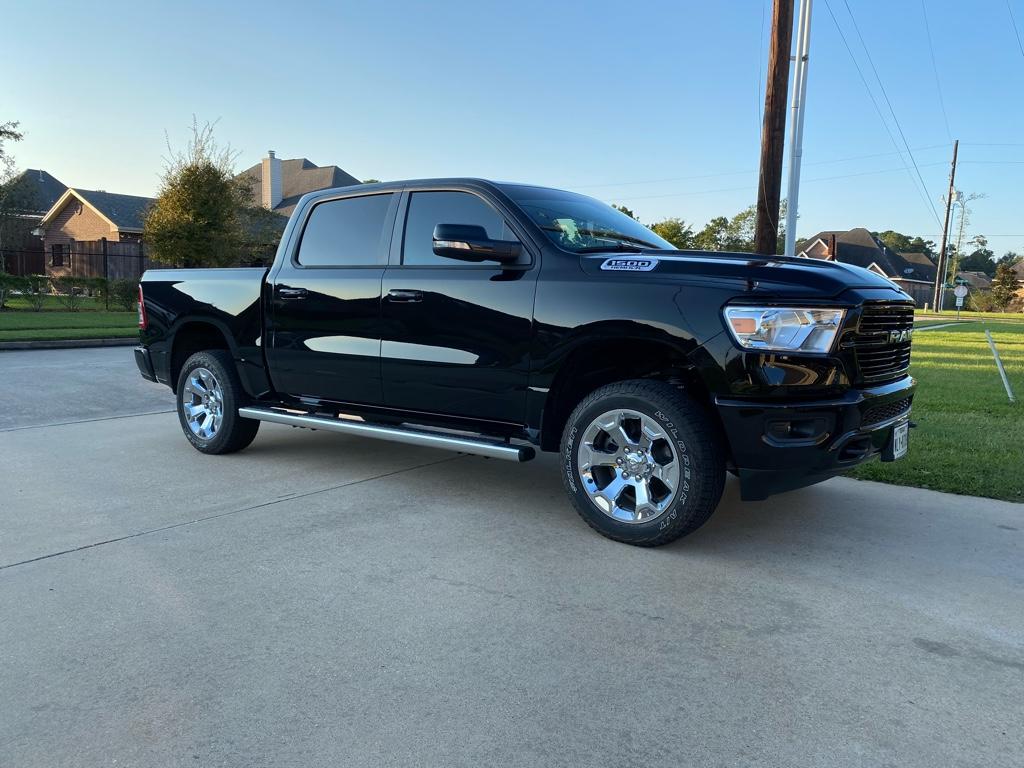

I have the Bilstein 5100's on setting 5 and also a 1/2 inch motofab spacer in. Sits only 1/4inch lower in front. Damn near perfectly level and rides amazing. Highly recommend. NO UCA's either.
Looks great but seems slightly nose high? Could just be the pavement?
I did motofab 2” spacers. Perfectly level
