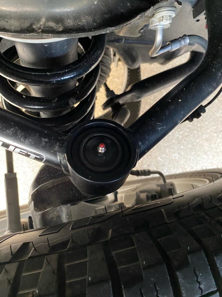

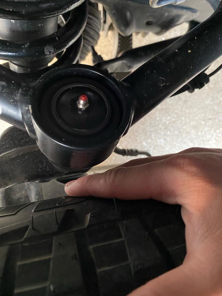

mine is the 2” readylift level, yes. here’s a pic of the space on the stock ATs.
my 4th gen with 35/12.50/20 on stock wheels was crazy close to the control arm. like half an inch close. haha

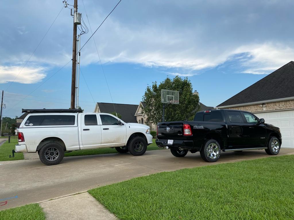

Do you have a picture of your truck with the 35s and level. I debated about going 35s but didn’t want to do any trimming plus they aren’t really rates for our stock wheel width. With all that said I still am thinking I want to do it someday.
here it is when i was test driving my current. it’s a 2wd 4th gen with a 1” block in the rear and 4” spindle up front, that truck was slightly taller than my buddy’s bilstein leveled 4th gen on 35s. it also had timber grove bags in the rear to hold up the shell. i love the new rig but damn it do i miss that white truck sometimes. mostly the shell, awning, and mods i did to it.
Ready
