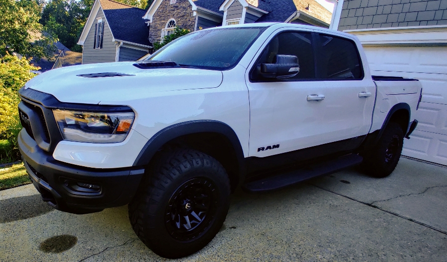

Same here - Motofab is the best bang for your buck. Threw on some 285/75r18s at the same time and it’s all I’ll ever need

here is an overview and review of my setup.
Fox 2.5 DSC, Carli UCA, Carli Rear End Link, Carli Rear Spring
35x12.5R18
