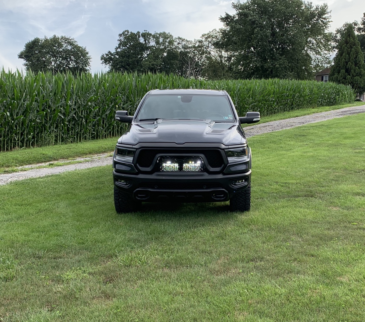

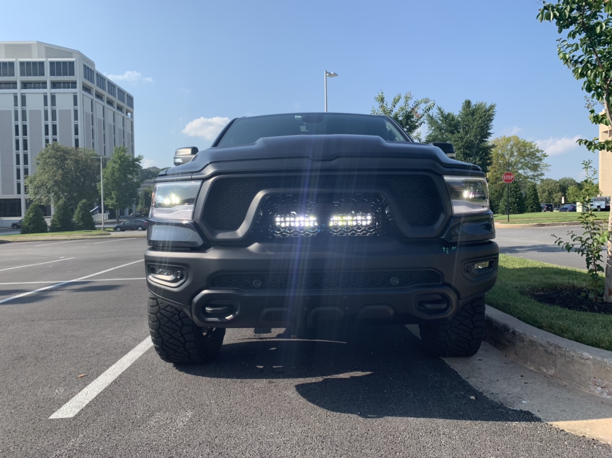

Added the 20” LED light bar into the grille area.
Baja Designs used my truck as a tester to make brackets for the 2019 rebel. I have the light bar currently installed and am waiting on the fog lights and rear lights. It’s currently on a prototype mount but it looks good and works great. I will post photos once I have all the lights set up.

It’s a 20” light bar but it produces a ton of light. They talked about possibly some other light bars in the grill as well. I don’t have more Info but they took measurements of everything from my truck.

Switch placement is right by the foot pedal extender switch. Easy access for my left hand to reach. Provides plenty of light in the dark areas
