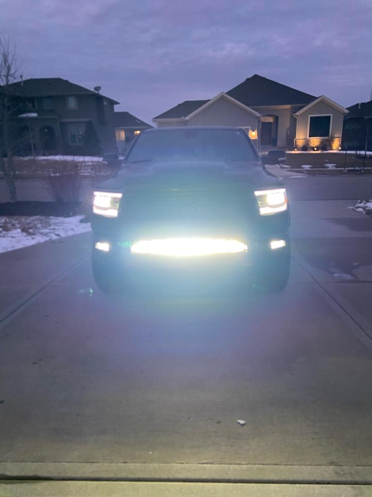

Does anyone have the wiring diagram for the drivers side LED headlight housing? I’m looking to tap into the high beam and DRL wires to control the two modes of my aftermarket LED light bar. I’m planning to use these two wires or fuse taps as inputs to trigger my relays.
Update in case anyone else is looking for this information in the future: the HI beam wire on the drivers side is white with green stripe on the factory LED headlight harness.
I still need to decide how I’d like to operate my light bar DRL functionality, whether I tie into the factory DRL or low beam. I currently have no idea which wires carry those signals. If anyone knows or has a wiring diagram, I’d greatly appreciate it.

Short answer is... kind of. My light bar has a low light DRL option that’s about the brightness of my phone screen. I do want to plug that into my DRL circuit because I like the look of it. That current consumption is only 0.6A vs the full brightness light bar at 16A+ (measured).
I did wire the full brightness into my HI beam for times when I want it to automatically switch on/off. I can turn that feature off on highway use so my HI beams will not trigger it in that instance.
The DRL beam is no more bright than our factory DRL. Kind of a neat option on this particular bar.

Hey guys, I wanted to share the lighting controller I’m using in case it’s of any value to this crew. I’ve installed a Garmin PowerSwitch to manage my outputs. The PowerSwitch connects to my phone via Bluetooth, and can be controlled by App or automatically via either of two control inputs. For example, I hooked my full light bar brightness to my high beam control input, and my DRL light bar up to my DRL control input. I can disable either input via the App. Most importantly, I don’t have any need to wire through the firewall or install a switch panel inside my cab.
Don’t mind the wiring, I could use to tidy it up a bit, but here’s my PowerSwitch install.
