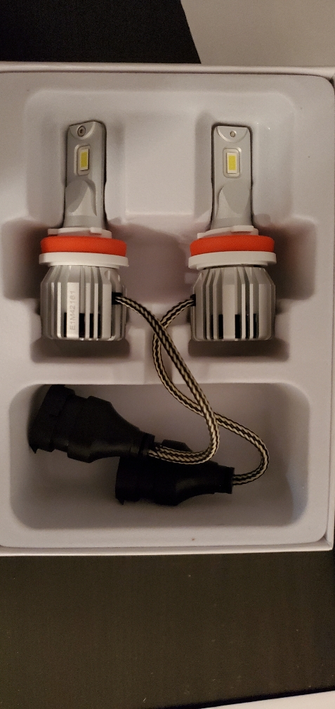

For my Lone Star, I used Lasfit and there were no anti flicker modules.
I used the following:
View attachment 81727View attachment 81728View attachment 81729
Its the Bighorn Sport crew cab. The reason I ask is because on Headlight Revolution, in their video he states no matter what manufacturer you use, put the anti flicker module in because the Rams do flicker without it. I jsut wasn't sure if I needed it for the high beam as well.
The Lasfit I installed have no modules and they have been flawless from day one. No flickering, no issues. That is my low beam, high beam and fog lights with zero issues.
