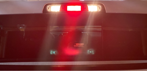

I purchased these same units and installed tonight. Only tested starting the truck from 5’ away and remote opening the tailgate a couple of times and no interference. Granted, time will tell.
Still blows my mind that these were the only non-led bulbs on the truck.
While these quick before and after don’t really show it, it’s quite a difference!
After:
Before:
*UPDATE*
Despite no issues last night, no key fob present message when I attempted to the start the truck this morning. So something with those LED’s must be causing interference. I wonder if that is why FCA didn’t put LED’s in there? Such an odd thing. Odd that some people report no issues with the ANTLINE LED’s. Will likely go with the more expensive LED’s mentioned in previous posts.
