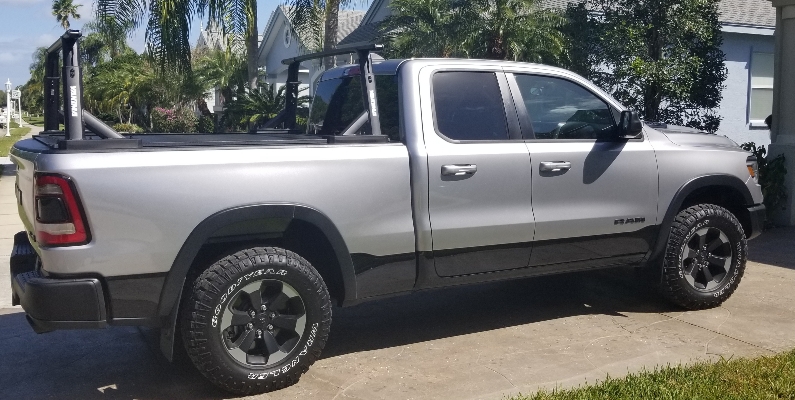

I use a Yakima setup for my Kayaks. It works great and it’s very adjustable for ladders, cargo, racks or even a tent.

I’ve got the Yakima Overhaul HD also - don’t have pics with the kayak up top yet.31095

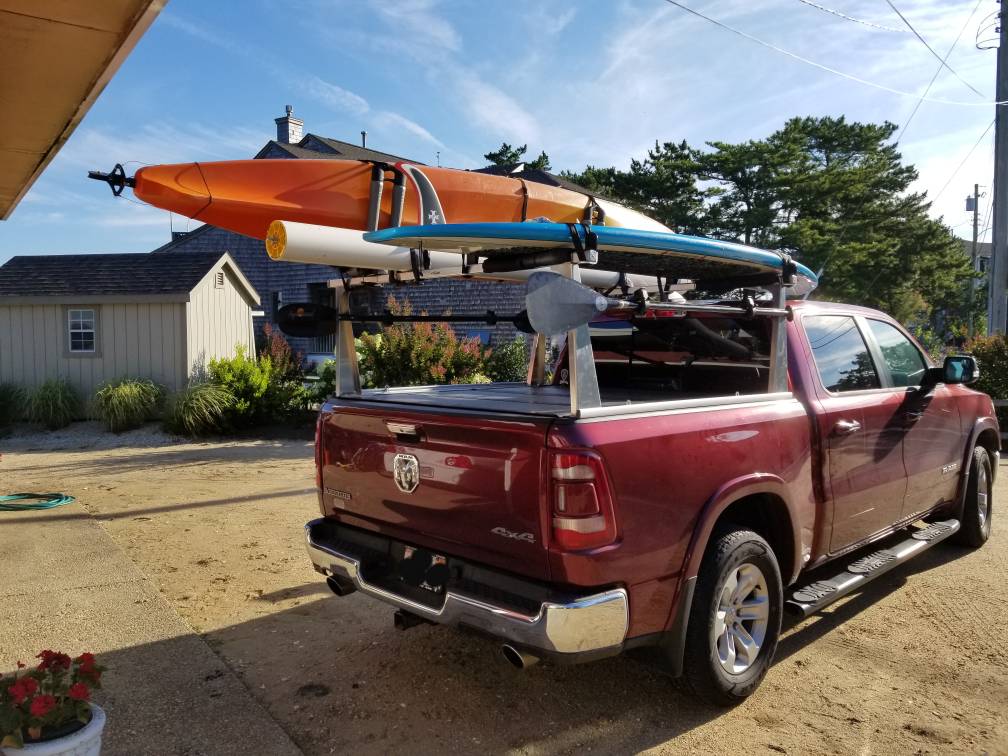

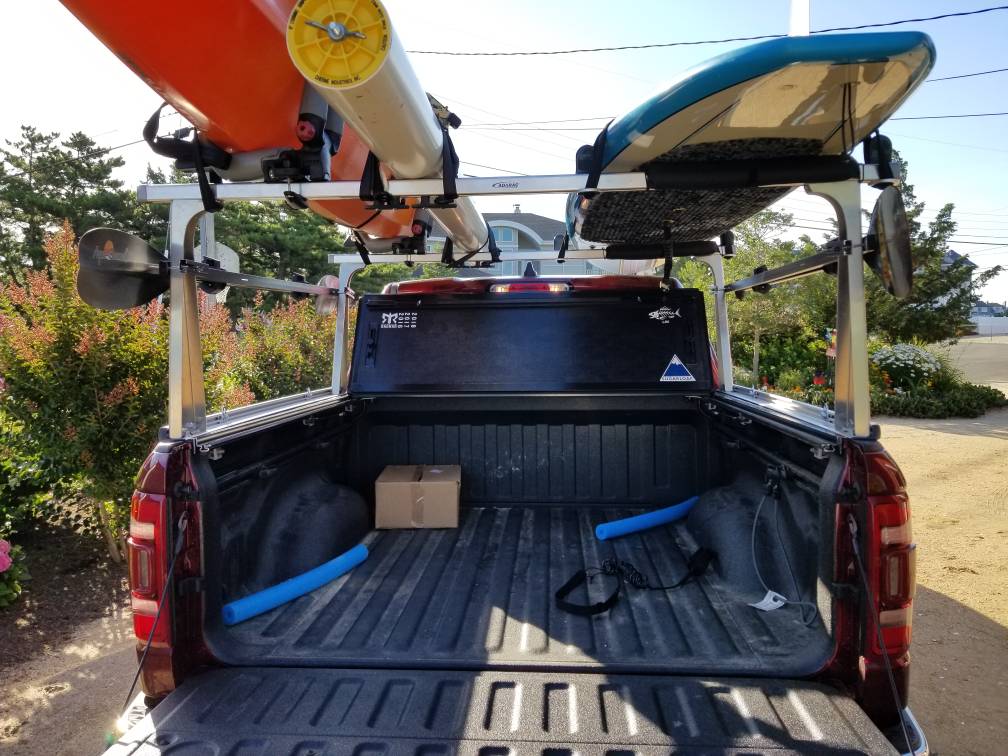

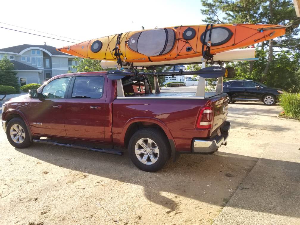

I realize you asked this question long ago now and may have already made a decision, but figured I'd jump in. I carry my 14.5' kayak and my wife's paddle board on the roof along with a 6" pvc for rods and such. I didn't want to give up my bed or the use of my hard folding tonneau cover. I also have a bike rack in my hitch (not pictured since I was still loading when I took these). I did a lot of research to find a sturdy setup that met those wishes and settled on the Adarac Aluminum Pro Series. I love it and the whole thing comes off the truck in 15 minutes or so. You could leave the side rails on if you felt like it for even less work. The cross bars are wide enough that I could easily fit more kayaks if I expand my fleet in the future as my son grows up. Installation is also easy enough to throw it on if I'm making a run for some long lumber, etc.
8hr drive with no issues at all. Bed full with other gear, and I like that my truck isn't significantly longer than normal for parking and such. The quality of the rack was impressive and the side rails leave options for other accessories/lower cross bars in the future. In all this is a quality platform that is great for what I need and has many possibilities for future mods.
For the paddle holders, I made the side cross pieces out of electric track light rails when I realized my paddles wouldn't span the bars. Worked for a short-notice addition for cheap $.
