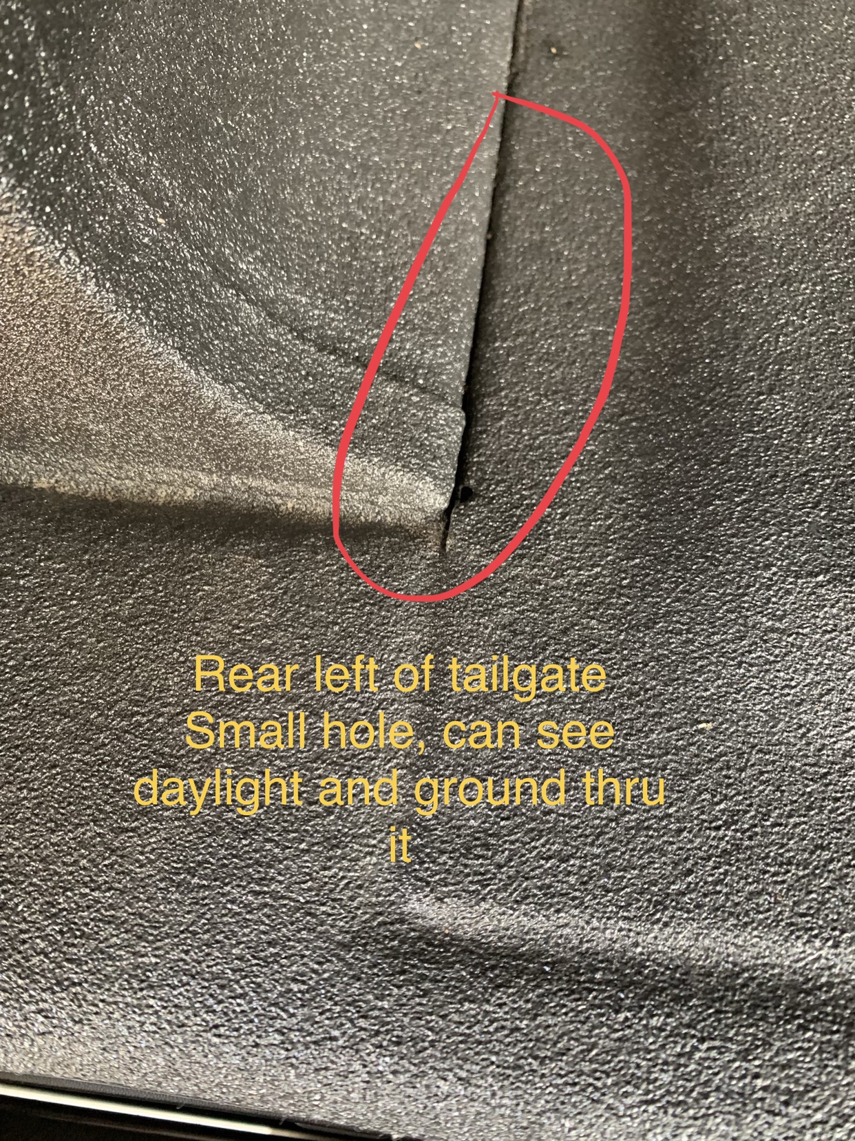

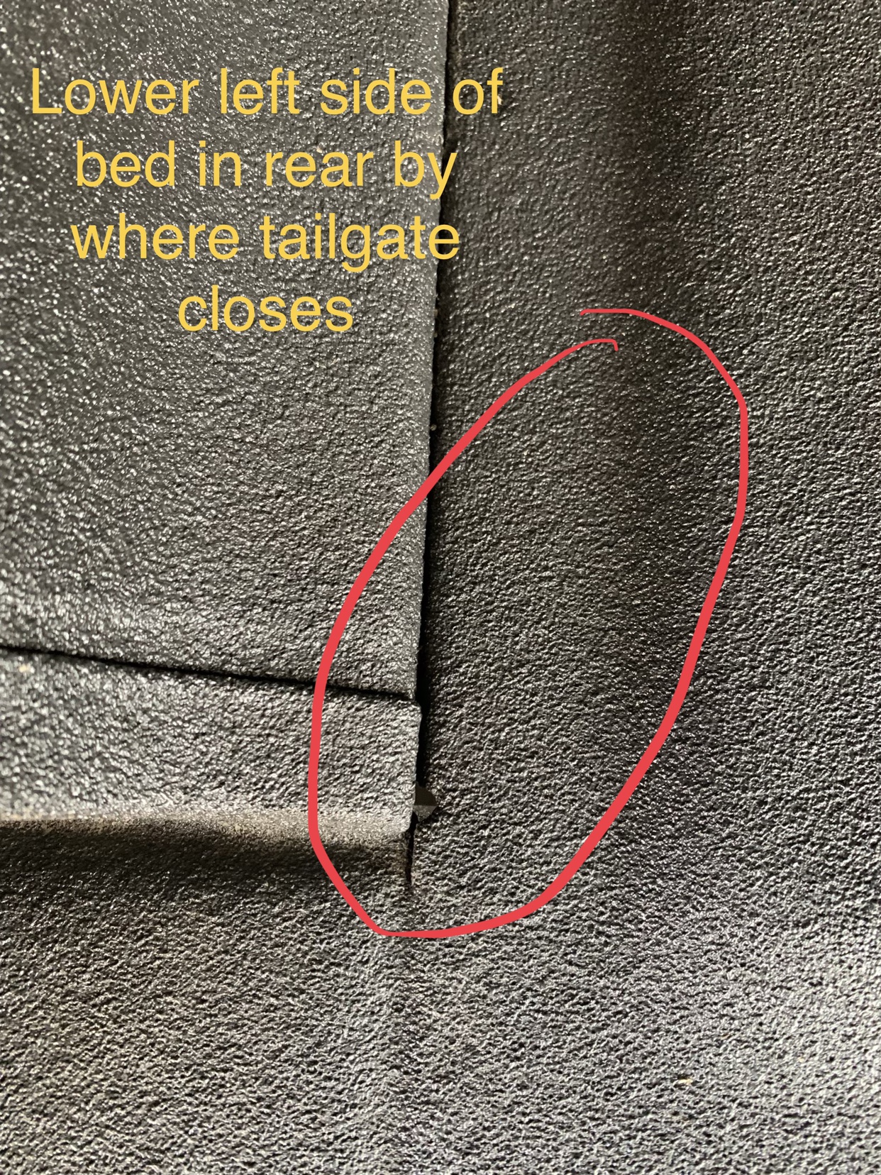

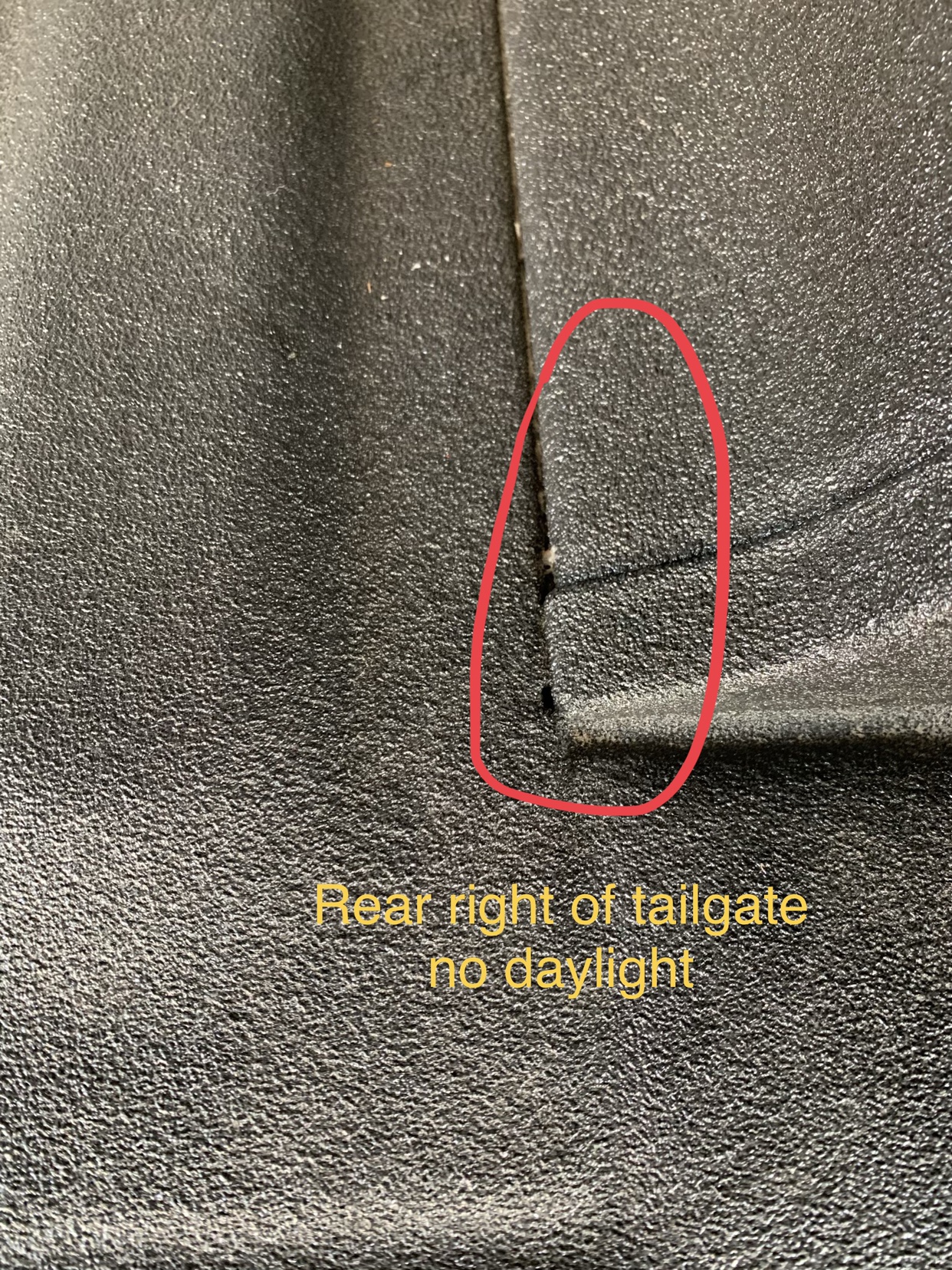

Hey everyone haven’t had a chance to Introduce myself yet but I had a question. So I purchased a new 19 limited with etorque and ramboxes etc.

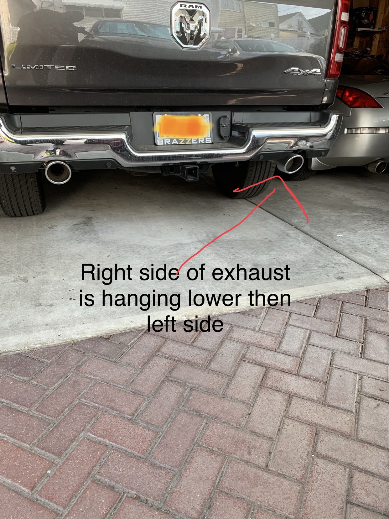

I attached some pictures and noticed this on my bed which has the factory spray in bed liner. On the left side right by the rear on the left side seems to have a hole and you can see daylight and the ground thru it, passenger side can’t really see the ground or any light. Also my exhaust tip on passenger side is lower now then driver side for some reason. I’ve had the truck 1 month and have 1200 miles on it.
This is my first pickup ever so I don’t know much but I’m guessing this isn’t normal. Just wanted to share and see if anyone else has this issues. Also if so, any advice or how should I proceed? Thanks

Bring it to the dealer. Also, why blur your license plate? I never understood why folks do that.

My factory spray in liner has the same small hole. I am guessing it is a drain in case water gets in the bed

The exhaust tips are an easy adjustment. Mine were equal but hanging lower than I wanted. It's a 1/2" socket to adjust. Just loosen it a bit and you can adjust it.

The beds on truck are not designed to be water tight, i.e. completely sealed up. It bugs me a little but I just think of it as extra water outlets aside from the intentional ones up front. I've yet to see the Germans design a truck bed.
Now imagine what they'd look like without the spray in bedliner...
