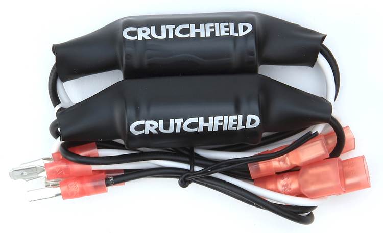

Do you have the alpine or the base system? If you have the bsae 6 speaker system you need a high pass filter also known as base blocker. Something like 300 HZ cut off would work well.
