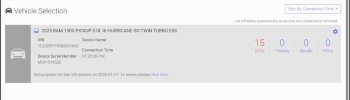

If you do end up getting set up to perform the proxi alignment yourself, these are the steps in witech:
Close witech, disconnect the device from the OBD port, turn truck off, open then close door, and let the truck sleep for 15 minutes.
After the truck has been sitting for 15 minutes, connect to witech again, and finish by clearing all the DTC’s:
