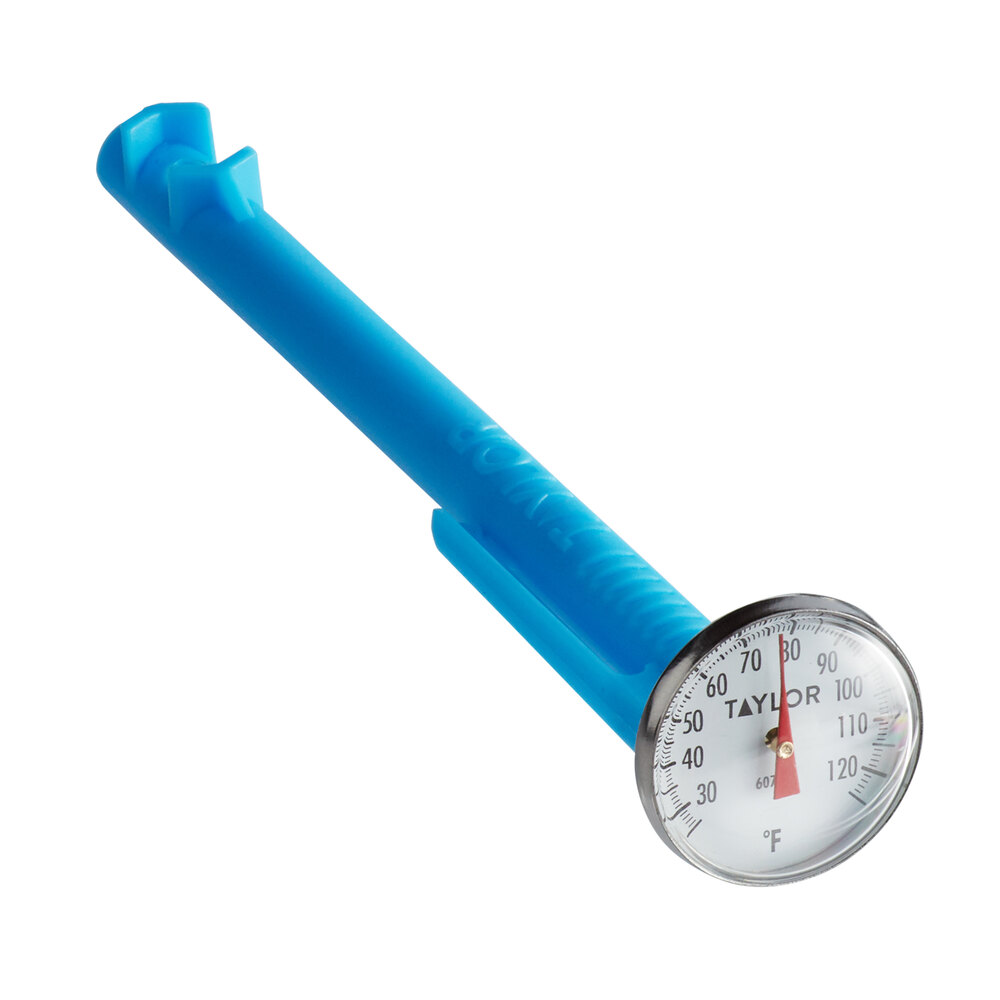

On all my cars I have in the air outlet a small 1" diameter thermometer.
I cut a little thumb size piece of foam to stick in-between the louvers for the probe to go though so it almost looks factory installed.
I've tried battery powered but the heat just cooks the little batteries so the old school analog work the best.
I like the Taylor 6075 thermometer the best because it has the smallest range between 25 to 120 degrees so it gives you the highest resolution.
Yes they make thermometers that have a higher temperature range but the Taylor 6075 is the ranges you will be dealing with coming out of the air outlet.
It's good to track trends to see if you might be due for an A/C service or just to know well the system is operating.
