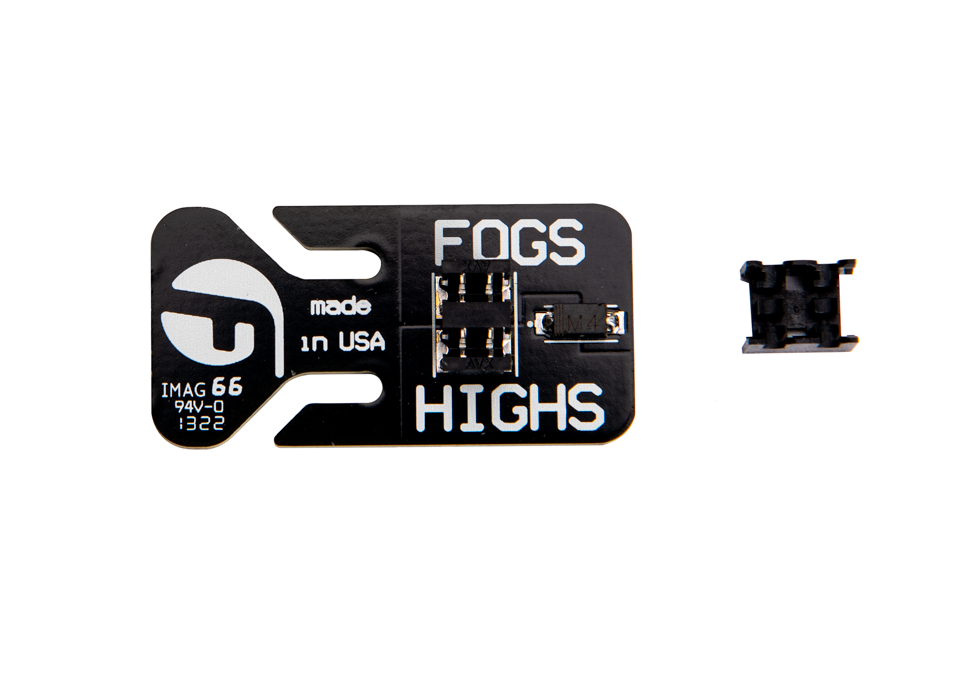

I am looking for the same thing. There was a company that made a jumper wire of some kind for the 4 th gen.

It's controlled by the BCM. Not going to jumper around it in the 5th gens.
