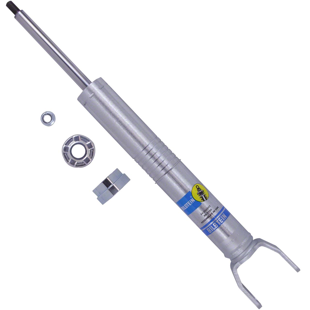

well maybe dealer did just change the shocks but if the original owner had for example done his own upgrade to Bilstein 5100 shocks - these shocks can give additional height on top of what the springs already give you and if you got the original Mopar shock from rockauto that could be your answer. That would be one guess
Did you get a copy of the rockauto order with part numbers or an invoice from the work order from the dealer with details or part numbers
This are Bilstein for reference
