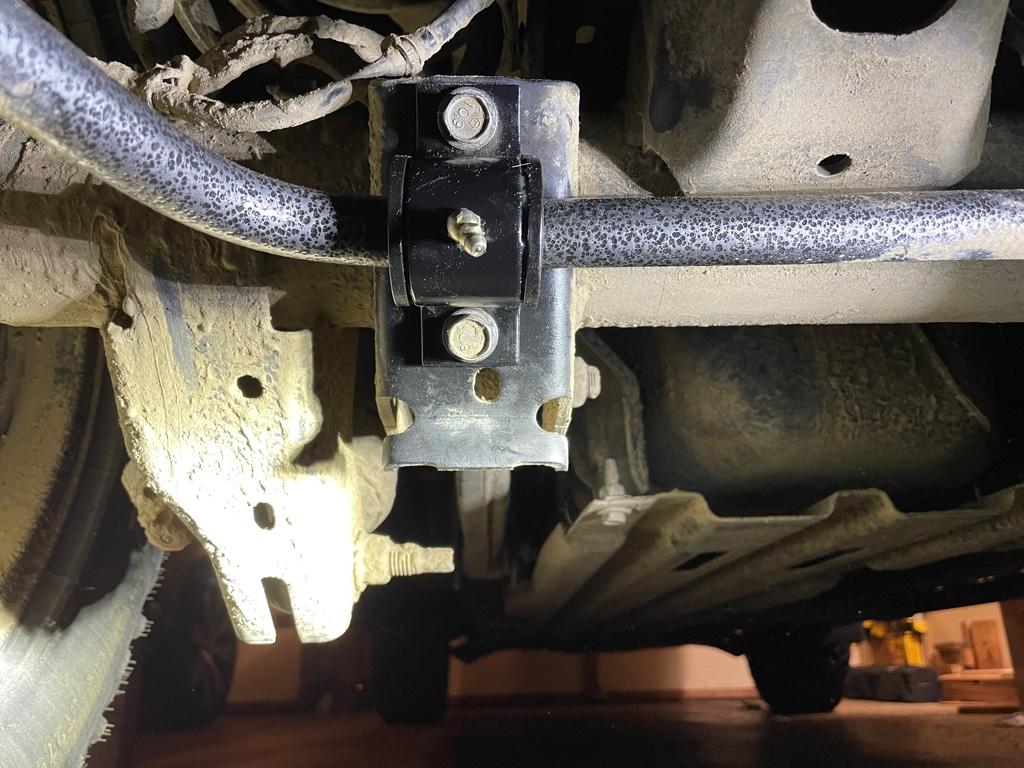

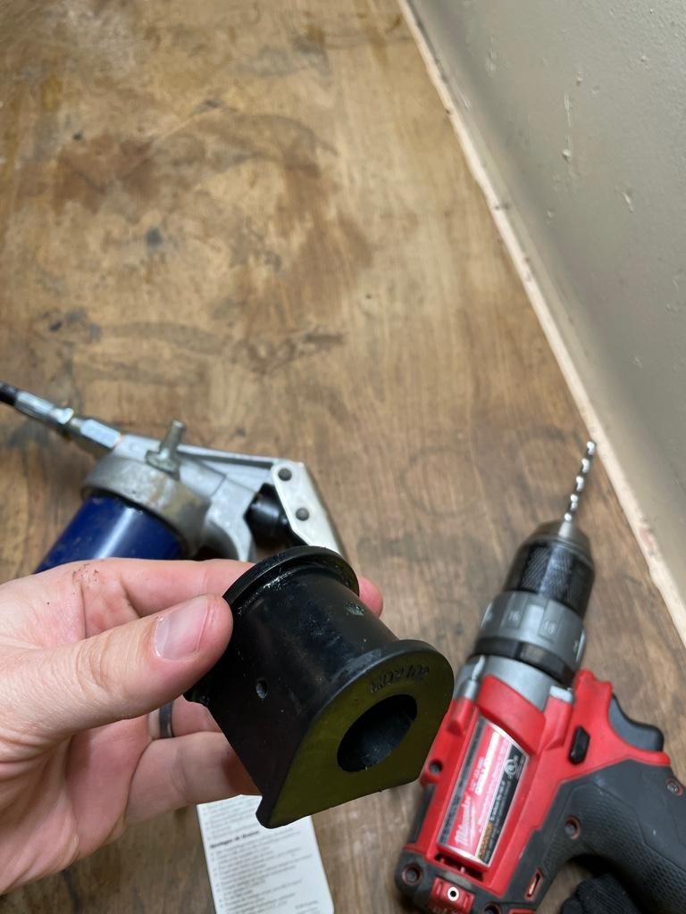

If I can find a drill press, I may try to add a zerk fitting to the mounts. I’ll report back if I can make any progress. The squeak is really bugging me haha

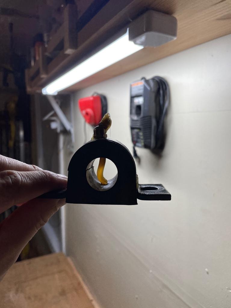

Have a tap kit and zerk fittings arriving Friday. It won’t be prefect but hopefully easier than taking the darn thing apart every few months. I’ll post back on progress when I make time to install
I did one side. Not extremely happy with the results. The grease mostly shoots out of the side of the bracket instead of the bushing. The question is how much grease is making it to the inside of the bushing. I’m going to leave one side normal and test to see if it is actually any better over time. The install took about 10 min
