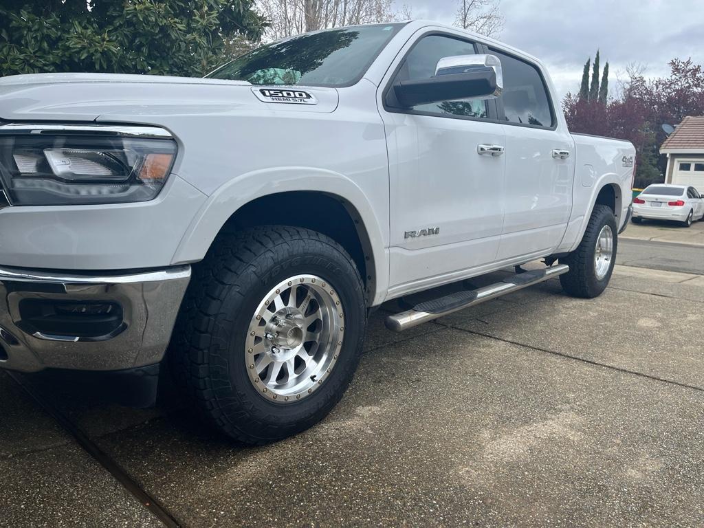

Got them put on today! Very happy with them.
