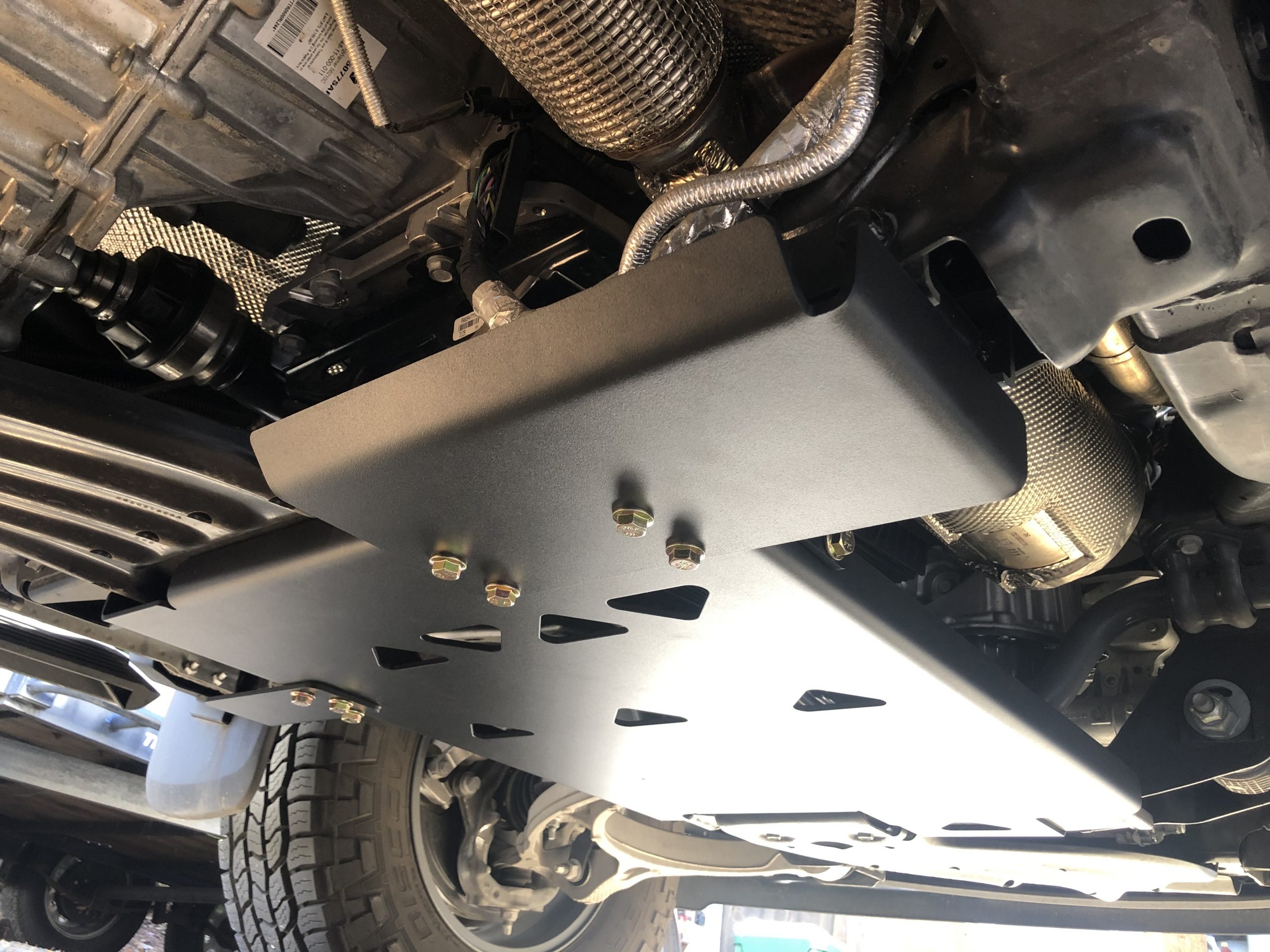

New to the forum but just got done throwing a skid plate on the front. I too didn't like the idea of not even having a splash shield up front and couldn't find anything aftermarket. I made some cardboard templates and brought it into a local steel supply/industrial fab shop and had a plate cut from 16 ga steel and bent to my specs. It mounts flush to the bumper and crossmember. The factory plate bolts on top. Total cost was under $100 including paint and hardware.

How's this? It's noticable enough that I didn't want to cheap out on hardware but otherwse it's pretty low profile.

Thanks, those pictures are perfect. Looks like that plate will serve you well... I probably need to get one made up.
