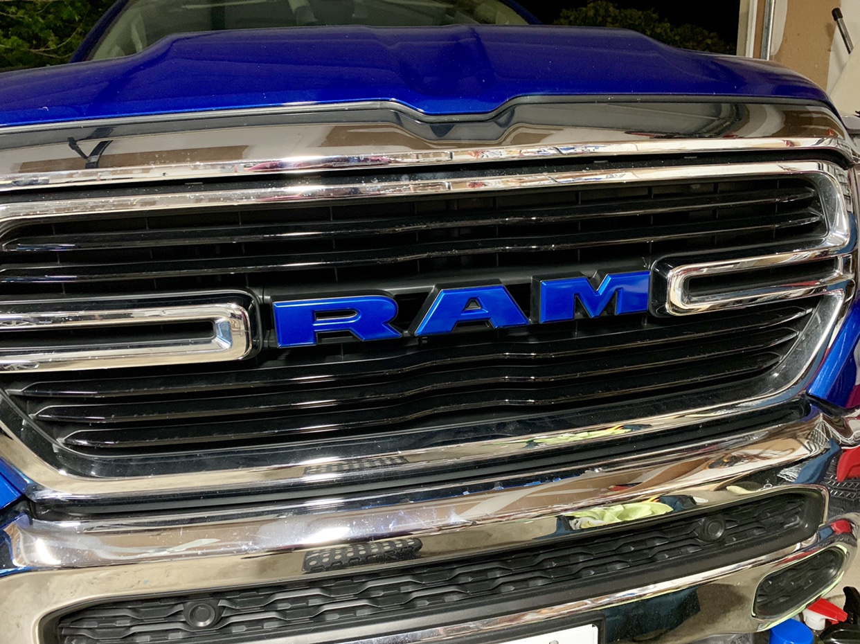

I just used a utility knife like Al stated earlier. Had them off in about 10 minutes and new ones clipped right in. Cracked a couple of the gude pins taking the old ones off however since they are round file bound I didn't mind. Please forgive how dirty it is. I just wanted to document to share here.

^^^. Nice, can you take a photo from further back so we can see the entire front please ?
