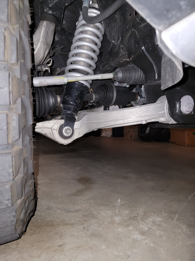

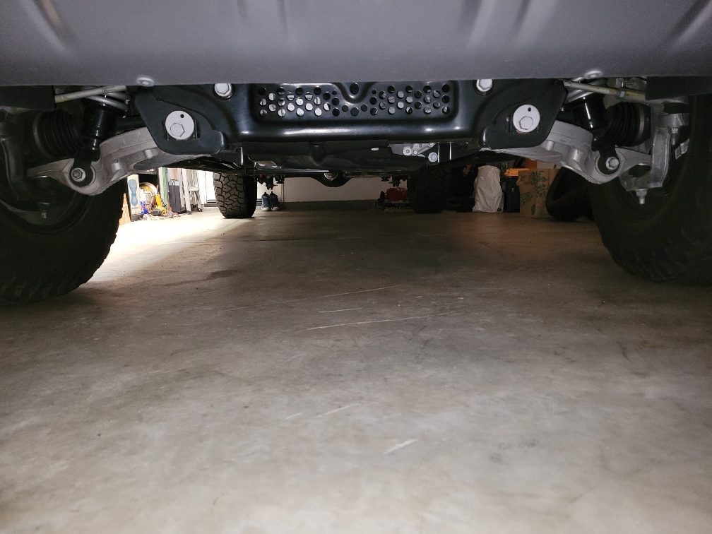

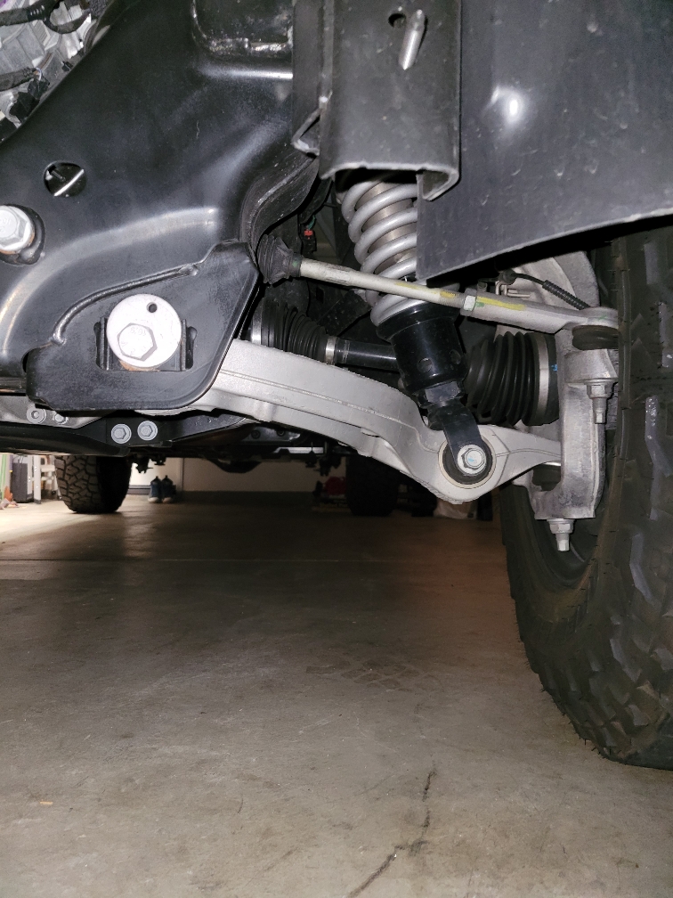

Anyone able to post a Pic of theirs? I dropped mine in today, set at 1.5" of exposed thread or 1/2" more than factory settings, and my angles look pretty bad. Wanted to compare with anyone running the kit at full height.
I had new spring put in due to the diesel and I'm wondering if that jacked with their recommended settings. With Clayton 2.5" rear springs I only have 1" of rake right now. I had icon 2.5 on it before, so my pre and post lift measurements didn't give me a good baseline.
The inner scares me the most.

As long as you can get an alignment you are good. If you want the fullest travel, get good uca's. Not crappy ones.

I'll run it for a few days to see if it settles a bit before cranking it back any. I'm running JBA UCAs with high-angle joints. No weird noises or vibrations so far, just seems very steep. I'm measuring out at around 25.5" hub to fender which falls in line with some of the 3.5" Readylift numbers. May have to take it down a shade if it doesn't settle out.

I set mine at close to 3 and I'm fine. JBA's are good.

Thanks, sir! I appreciate you taking the time to post that.
Yours definitely looks a bit less severe than mine ended up. Did yours settle any or stay about where you set it?

I don't believe it has moved. It's seen some serious off road miles. It it was going to drop it would have by now.

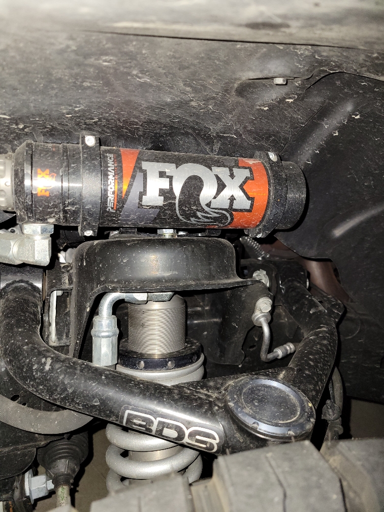

Here are mine, I have 1⁷/⁸" threads showing. I've had mine on for a year now, so I'm sure no more settling. Best of luck!

Thanks for the additional pictures!
I spoke with Accutune and they said going from the 450lb spring to the 550lb spring(both 16") wouldn't impact the amount I could preload.
No clue why it's so extreme. I'll look at backing it down a few turns today. I do know with the 550lb I had to use a compressor to increase load. It bent the tool without it even off the truck 😂😭

That's a real drag, I removed wheels and tires and used same punch and the huge Fox spanner wrench, Thought I would die trying to add a 1/2 more threads. Gotta say that spanner saved me.
Have you got one of those? Fox shipped it fast
