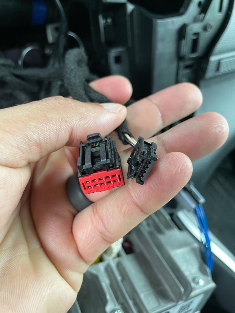

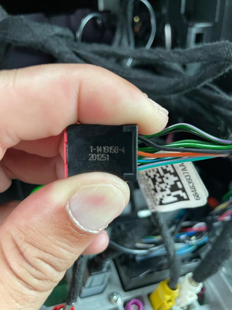

So I found these two cables behind my radio, does anyone know what their for?
They were factory taped to the wire harness.
For additional features your truck is not equipped with. Trailer brake controller, etc'

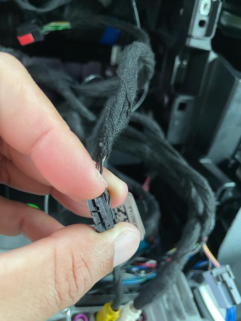

Do you recall if there was one more loose connector laying around, probably more towards under the front of the center console area?DAA4750E-ABF9-40AF-9B5D-7B7FDE4C63C5.jpeg
Yes I did see a couple of extra plugs above the shifter area.
Sorry, I meant more towards the glovebox (area circled in blue). If you can’t recall, no big deal- E419574E-DF44-4125-95C5-5D9FCEFA4275.jpeg
I’ll try and take a look today, what would that be for?
That one would be for the reverse trailer steering module. I was about to custom build that harness for another member to add the feature, but may not be necessary now.
