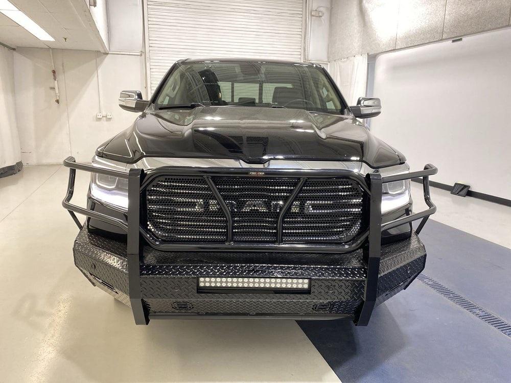

Full disclosure, I just bought this truck a PO installed a upgraded front bumper. From all appearances, the factory fogs are still mounted in original location.
Here’s my issue the dealer can’t figure out:
At night, when turning steering wheel left 90 degrees, the left fog light comes on. It does the same thing when putting on the left turn signal. The right side never does either of the above.
I can’t find in the owners manual. One might caulk it up to the new bumper but I can understand how this light knows how to turn on when steering or using factory turn signal. Either the right side is broken or the left shouldn’t do this.
Any ideas? Thank you.

I’m replacing the bumper today so I can run down the wire. What actually was happening, being in front of the truck to see it, when left the left fog and light bar came on. When right the right fog only comes on. It’s so dim I never noticed the right and left so bright I never considered it was the bar too. Definitely messed up wiring. Disappointed the Ram dealer had no clue what I was talking about regarding lights coming on when turning. Can’t find in owners manual either.
It's in the owner's manual on the page that describes the turn signals.
