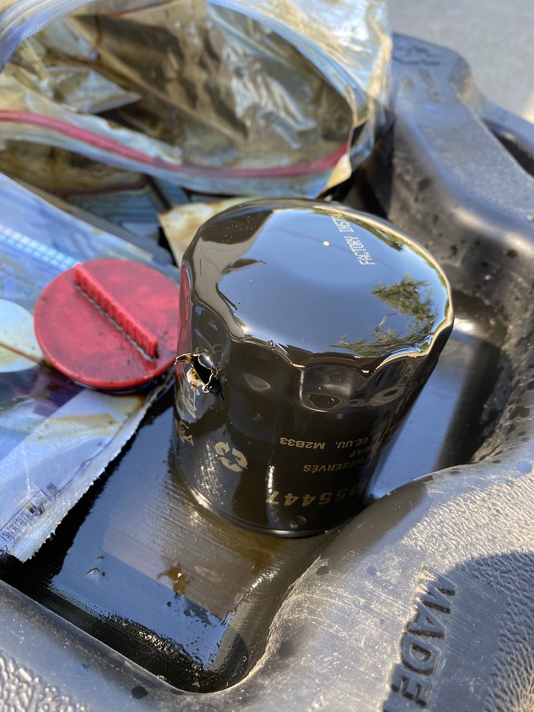

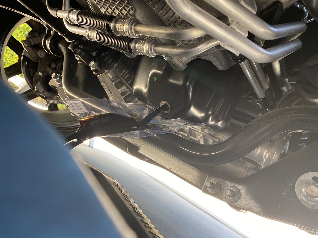

So I did my first oil change today. I did it at 3500 miles. It might be low but we are planning on going on a road trip soon. I went with the Mobil 1 (5W-20) and Mobil 1 (M1-113A) oil filter. Anyone else using this brand in their Ram 1500? I cut a used water bottle to make a ramp for the oil to run off into the oil collection pan.
It looks like there are a few people on here complaining about taking off the original oil filter too. I also had that issue. I wonder what torque spec they used at the factory but it was a ***** to take off!!!! In the end, I had to drill into the filter so I can run a long screwdriver through to get some leverage to take it off. It was quite a task!

Nice job. Speaking from exp of 3 new rams, u can just shove a flat-head screwdriver thru by hand ;) And always hand tighten the replacement OF by hand - never a single issue
Oh and that's the exact oil & filter Ive always used in every ram I owned (5 total). Its a great oil
