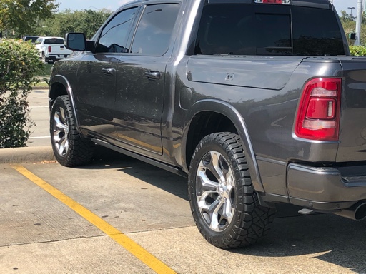

What suspension setting are you at in the photo? How long are yours link eye-eye?
Thanks
Thanks
OR 1 . Still one click to go !! Lol. Here is a pic in normal. Eye to eye was 50 mm . This creates a dead level stance for the truck every 5 mm Longer drops the truck 1/2
